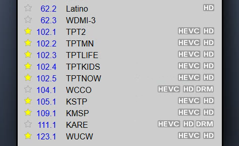

Good points - although the 1080p sports broadcasts POP - the higher resolution+higher bit rate make a crazy difference in color. My whole family was like "wow" when I flipped between channels.
Finally the guide in the Sony sees the channels "correctly" but its so frustrating when the new ATSC3 channels have no guide data or aren't shown correctly - or they aren't even flagged as different so based on how much data your interface is giving you have to guess at which is which. This is such a bumbling and industry driven (for questionable reasons) rollout that its hard to see how it goes well.
Not only that, but they (broadcasters) can sunset their previous version ATSC broadcasts like 2 years after they enable their ATSC3 broadcasts? That's so not going to happen.
Our local public TV actually has NextGen features, like on-demand and OF COURSE you can donate during a fundraising drive by just hitting the button on your remote 😀 But at that point, its like I'll just launch the app for public tv? It's so niche and the idea that ATSC3 requires internet for bidirectional traffic is just ridiculous.

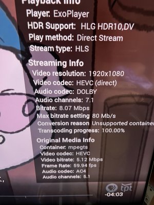

You inspired me to login to my Emby box - its been months - and sure enough has a backlog of Windows Updates and notice to reboot for Emby server update. Thanks for that as well 🙂
Looks like Emby is recording it if its there (previewing in browser locally on Emby PC):
I need to go test an Android TV device with direct playback to see if its still transcodes it. Obviously plays back very smoothly with this transcoding settings.
And it looks like with the right playback device it’s in its full glory:
Now if only 50% of the channels I wanted weren’t DRM disabled :/ Freaking ridiculous.
