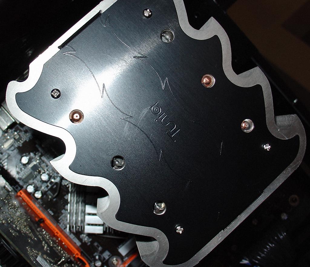

Here's a snapshot of the Tuniq sitting in my rig.
I have another one, still in the box, that looks the same, sooooo...
Does yours look like this, minus the fingerprint? 🙂
Yup that's exactly what mine looks like from the top
hmm
OK i guess i don't have a faulty one. It's keeping my e6750 nice and cool even at 3.4
