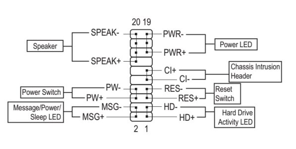

You disconnect everything from the Mobo and the PSU. Take it out of the case put on a table (not a metal table) plug the PSU, Memory, and GPU. Connect the GPU output to a Monitor, Plug the PSU to an outlet, and the PSU output to the Mobo.
Look at the Mobo manual and find where are the two pins that the front Panel plugged to switch on. Switch On the PSU and use a screw driver to shorter for 3 sec. the two Power pins.
Example: The Short would be between PW and PW+ (left side down).
If it does not start get a PSU Tester (about #12 on Amazon). If the CPU tests OK you need a New Mobo.
If it is working on the table, then some thing is wrong with the Case wiring, or and switches.
Good Luck....
