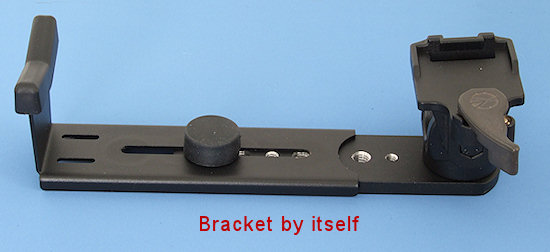

I think you're looking at two issues.
First, I'd consider a telephoto support rail; something to lock the body and the lens together to take any bounce out of the body/lens. And then that single solid unit mounts to your tripod. You can buy something like this or DIY.
You wouldn't need something that adjustable or quick-release. Assuming Canadian tripod mounts are 1/4"-20 thread. You just need something for the rail, two blocks to mount the body and lens supports, a hole in the rail to mount it to the tripod, and some 1/4"-20 hardware. This might firm things up enough to get the shot.
The next step might just be a better tripod. Are you getting any stiction with yours, where it's bound up and let's go all at once, so you can't smoothly make small adjustments? I'd visit a nice camera store and try out some nice tripods just to see how good they can feel.
