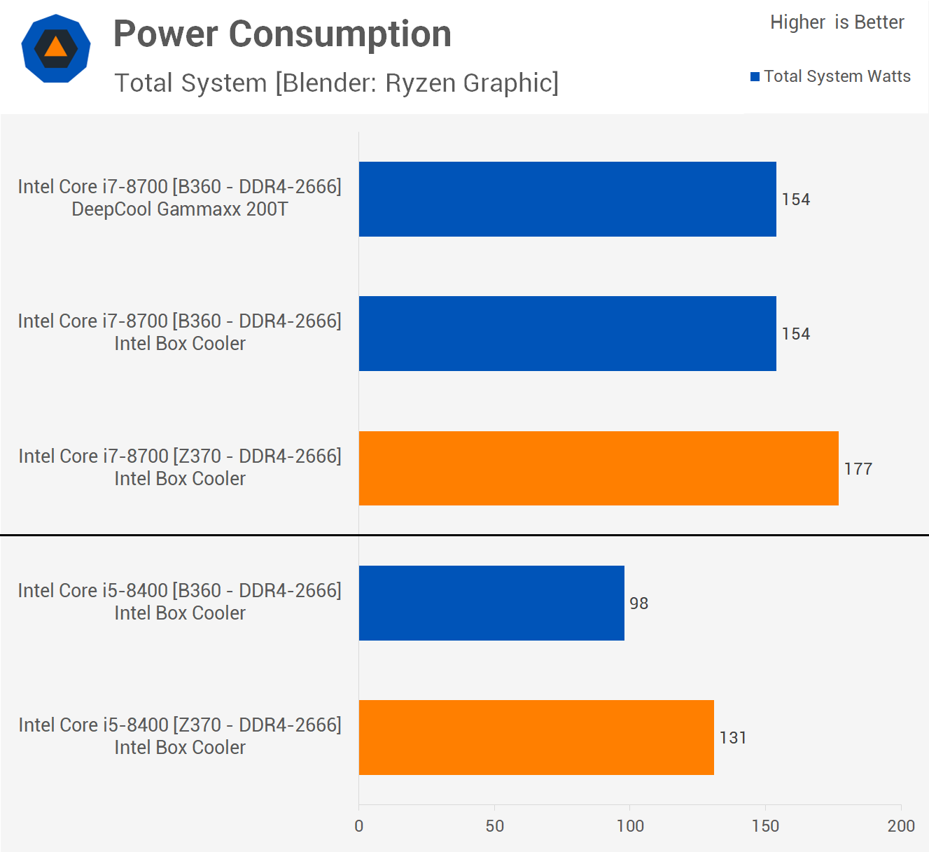

Came to mind from this review:
https://www.techspot.com/review/1603-intel-b360-chipset/
A 33w reduction (25% total system power) with zero performance hit is very attractive to me. As you say, I'm sure that varies from board to board, but Intel is clearly the better option when it comes to performance on a fixed power budget.
The i5 8400 would probably be my choice. At a package power of ~50 watts, it outperforms any Ryzen CPU in nearly every game. That's 30% less power than an R5 1600 and around 45% less than a 1700X.
And, NV's current GPU design is considerably more efficient than AMD's - the GTX 1060 performs at ~120w about as well as the RX 580 does at 185w, just as an example.
My 2 cents.
That data does not directly imply the B360 chipset is the main reason the MSI B360 Gaming Plus is more power efficient than MSI Z370 Godlike, Steve clearly pointed out he was comparing a $500 feature rich board vs. a $115 budget oriented model.
Take a look at the power delta between these Z370 setups in the Tom's Hardware review for MSI Z370i Gaming Pro Carbon, the ITX model. There's a near 50W difference between the MSI board and the Gigabyte Z370 WiFi under load, and these 2 boards have 10W lower idle power than the rest of the lineup. Same chipset, different board load-out and probably different power management settings.
