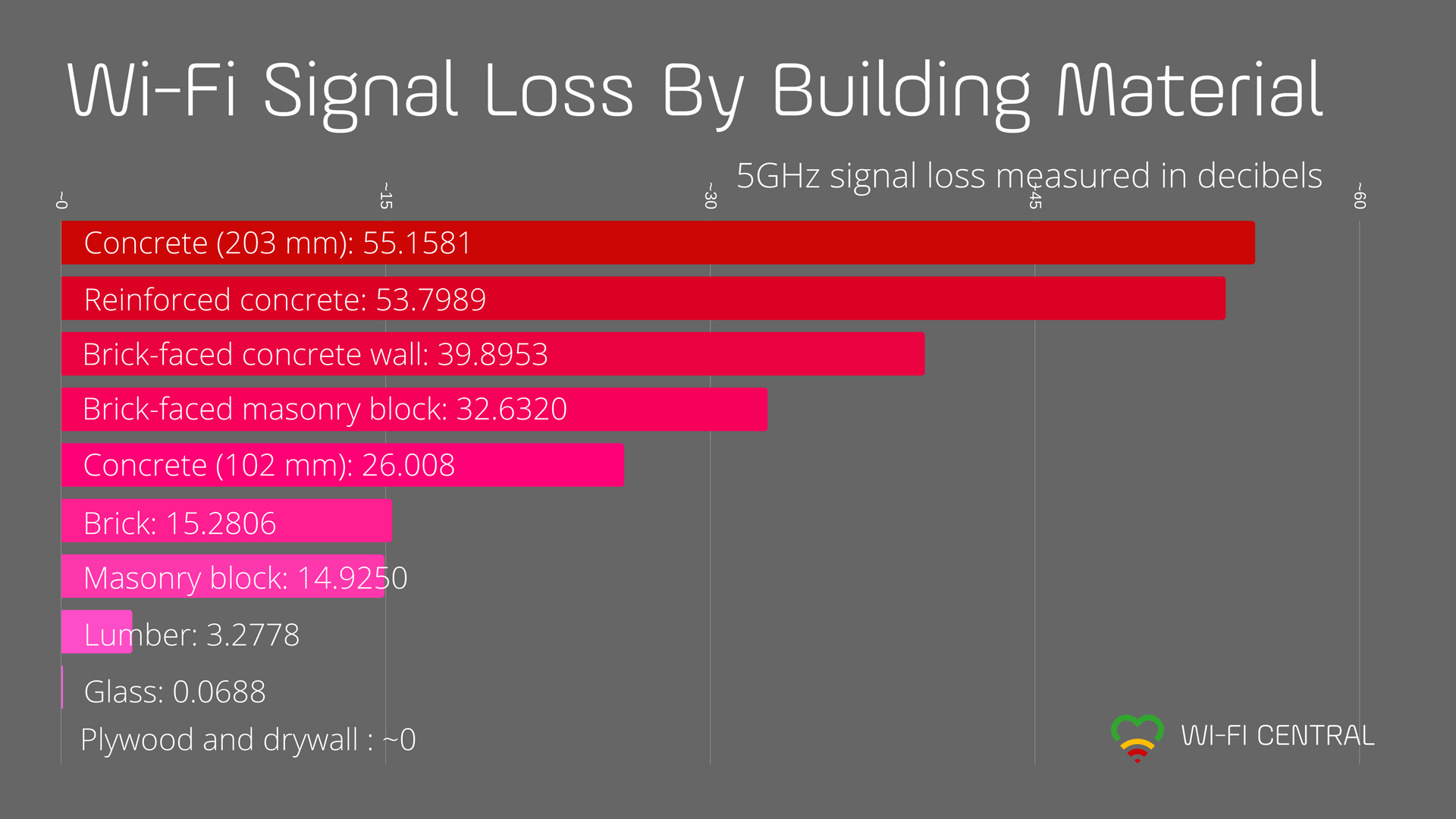

If the second and third WAP are operating in repeater/mesh mode, then yeah, bandwidth would be cut in half. (Everything you send the device, it has to turn around and send to the next device, then it turn back and listens to you.) The slowdown in the bedroom would be normal if you're connecting to one of the secondary mesh devices, and there's a wall or two in the way. (Stucco or plaster, by any chance? That always sucks extra. But not as bad as brick.)
Also, although the device is sold as "AC1300" the best it can do to a single 5GHz device is 867mbps, and cutting that in half is typical best-case "real world" performance, even if the devices have line of sight.
Also, if you're in an apartment building, chances are there's a bunch of other wifi networks, they might be interfering.
Also, you might be running into a limitation of your iPhone (depending which model it is.)
Given the small size of your apartment, you'll probably get better overall performance if you just set up a single WAP somewhere. Maybe. Depending on what your walls are made of and what kind of radios are built into your client devices. But you won't be paying the relay penalty.
tl;dr, wifi sucks, it provides inconsistent performance unless you're in a lab or testing in a faraday cage, and it will slow down if you look at it wrong. It's convenient and easy, and good enough for most uses. If you care about consistent gigabit-class performance, run a wire.
edit: Oh, and if you're running multiple devices in router/NAT mode, don't.

Oh, they're definitely in repeater/mesh mode. That's how they work. So yeah, bandwidth on the secondariiwill be half max.
The walls here are made of brick, but it is still not a very large apartment.
Doesn't matter. Brick is the devil.
I was not expecting to get 300 mbps in every room, but it seems disappointing not getting even 100 mbps (1/3 of the speed) in a room where one of the secondary Decos is installed, and just two rooms away from the main Deco.
Nah, that's about right. (1/3 to 1/2 speed for the relay)
And with the Decos having to talk to each other through a brick wall... You're lucky to get that.

those are good things but they won't overcome brick.

Routers can always be tweaked. Some have adjustable broadcast power settings or QoS controls that might offer some improvement. But in the grand sense? No, I think you probably did everything fine and this is what you get.
My Dad's house is an old farmhouse, with stone foundation and brick walls in the interior. (Most of the rooms were later additions onto a smaller stone structure.) WiFi performance there has similar issues to what you're seeing.
Yeah, brick is the killer. You are lucky to get the speed.
To overcome the signal loss, you have to drill holes and connect APs with ethernet wire.
