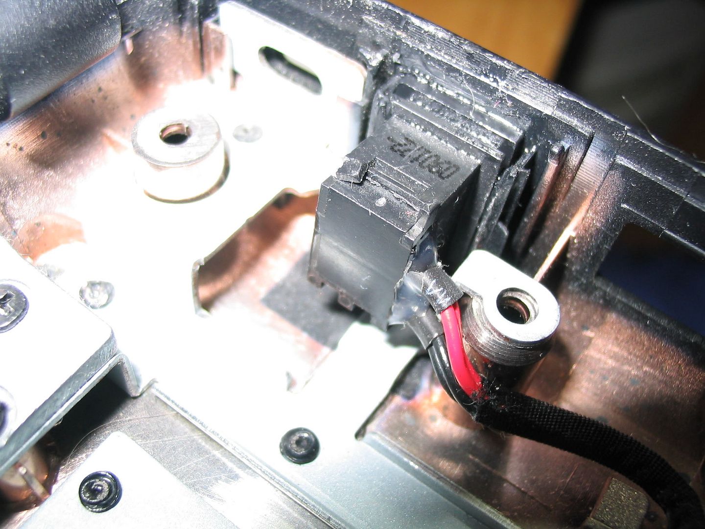

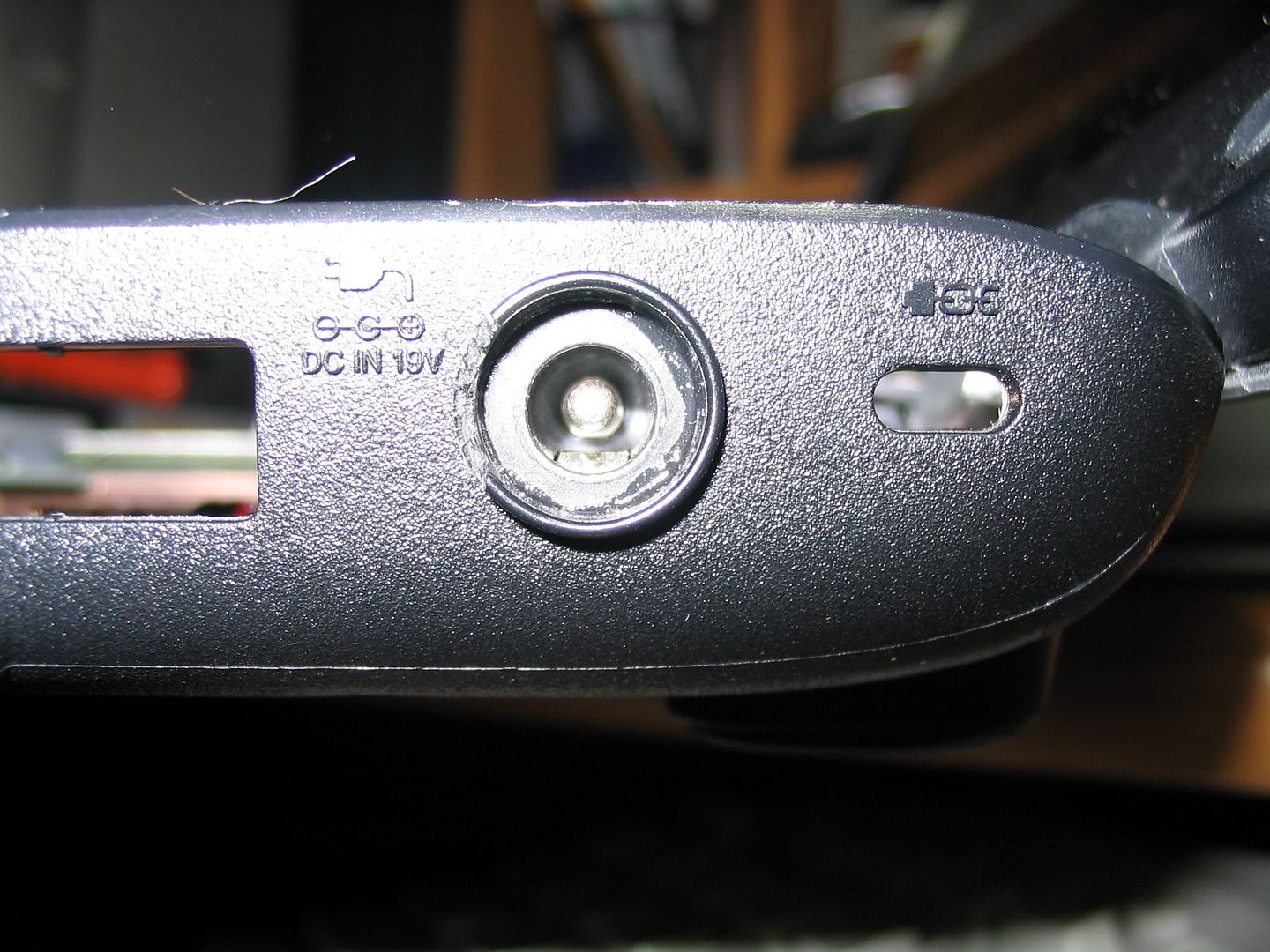

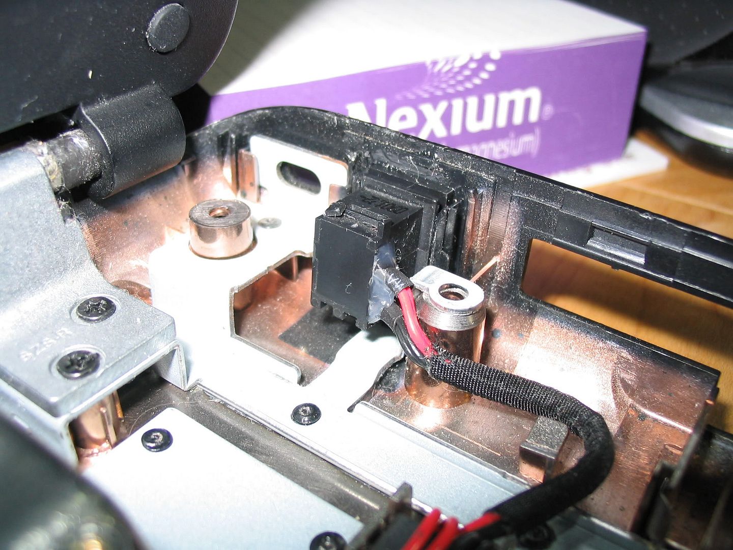

I'm including a couple of photos so that you can see what I see. I can shoot more if you need a different angle. But this is what I see after the owner super-glued the casing of the jack to the inside where it should never have broken off:

I stand corrected. It appears (after checking with a voltmeter) that it is the AC adapter that isn't functioning properly.
