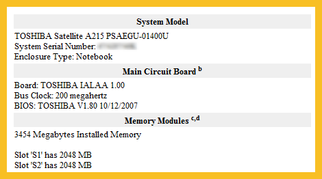

EDIT
HERE is a snappy of Belarc on my Toshiba A215-S4807... ;)
