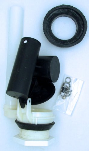

Thanks for that. Looks like an American Standard 4049 (Cadet). Pretty sure it must be the original flush valve from some photos.
This looks like it, minus the flapper contraption on top. On the one I have, there's a section that looks nibbled to the left of the opening (the seat itself, though, is still intact). Must have been where someone cut off the hinge for the original flapper when they replaced it many years ago, so there's no way to back to an original replacement.
It's easy to see from this that the center to center distance between the pipe and opening wouldn't have to be to any standard, since the hinge is to the side.
I'm finding some discussions about them on other forums. Mostly recommendations to replace the whole damned thing, but maybe I'll find someone who can recommend a flapper that fits.

So I did a little looking around this morning now that I had the make and model number and it looks like the flapper itself, (the rubber component that does the sealing) is no longer available from American Standard. That throws you into the secondary market and from your description, it sounds like continuing down that road may be just a further waste of your time.
Your best bet for a lasting repair looks to be to replace the assembly that you've shown in post #9. You'll need a big pair of channel lock pliers and only a few other common tools. Removing the tank is not really a big deal, I've done it many a time when painting.
