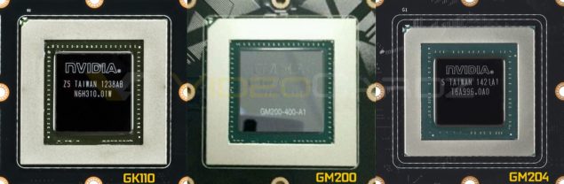

GK104: 3.54billion Transistors. 1536 cores. 23046875/core
GM204: 5.2billion Transistors. 2048 cores. 25390625/core
GK110: 7.1billion Transistors. 2880 cores. 24652777/core
GM200: 8.0billion Transistors. x cores
80000000000/x = 26600000 (roughly due to higher density with Maxwell like shown with GM204)
80000000000 = 26600000x
x = 80000000000/26600000
GM200 Transistor Count: 3007
Nearest SMM: 23, Rounding up to 24
GM200: 24SMM, 3072 Cores. 384bit, 12GB VRAM
Thats my estimation :thumbsup:

GM204 was a lot bigger than GK104 though. They don't have much room to grow from GK110, ~600mm2 is the limit at TSMC.
I'm expecting ~35% faster than 980 at ~780ti/Titan power levels (~220W), but they do have plenty of TDP room to clock it higher at stock for extra performance.

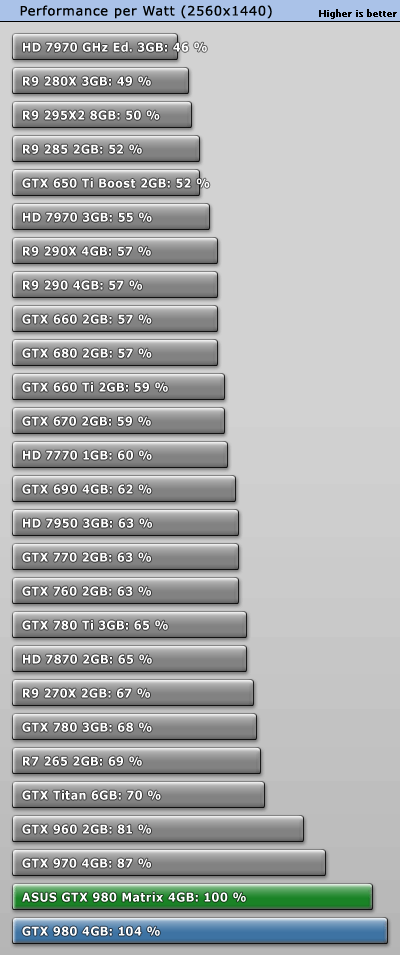

And it is for the exact same reason in both, performance/watt in relation to the other component suppliers. Aka Intel and nVidia in this case.
It's not that simple. Perf/w is a useless metric in isolation.
The problem for AMD is their CPU have worse perf/w AND worse performance outright. You cannot do well when you suffer that double whammy.
Before Maxwell, AMD was competitive with Kepler (R290X is these days faster than 780ti!), it had performance but worse perf/w. Then Maxwell just made that into a double defeat with the 980 having outright performance lead and massively more perf/w.
Their problem now is being late with a new gen GPU. If R390X arrives and is 250W (water, cool & quiet) with 50% performance gains, it will be very competitive.
There's no doubt in my mind, if AMD CPU actually was faster than Intel but had worse Perf/W they would be in a MUCH better place now.
Feb 19, 2009
10,457
10
Being only 35% faster than a gtx980 at gtx780 TI power levels would be a noticeable decline in perf/w over GM204. Kepler did not suffer a decrease in perf/w with it's bigger chips.
Nope, do your calculations.
980 = ~180W. I just looked at all the recent 980 review, all the MSI, Asus, Gigabyte etc are ~180W.
180 x 1.35 (keeping perf/w identical!) = 243W.
If you think the 980 is a 160W part, then 35% perf & tdp increase = ~216W.
Last I saw, 780ti is ~220W average load in games (TPU, computerbase.de, kitguru etc). R290X is ~240W.

You would have to compare the earlier launch results rather than years later. The reason for this should be clear as older stuff get left behind in optimizations or rather, newer stuff can be improved further.
At the launch of Titan X I expect it to be ~35% faster than the 980. Years later, it may well end up at 40-50%.
This is at the launch of the 780ti, at the relevant resolution when comparing to the 770, to give you context.
http://www.techpowerup.com/reviews/NVIDIA/GeForce_GTX_780_Ti/27.html
Perf/w is very similar to Gk104. So its clear NV's bigger die does not suffer worse perf/w (it suffers perf/mm2 instead, which isnt a metric thats important to gamers)..
So Titan X retains GM204's perf/w, extends it by 35%, it therefore should have ~35% more power use than the 980.
snip
Did you forget how to do math? 45% faster at 1440p which is exactly within the limits of what I said. I love how all the ultra 4k butt lovers run up with benchmarks at random resolutions to support an argument you try to create. Go through my post history talking about benchmarks and notice how I always stick with 1 fair-ground resolution - one that isn't unadopted (4k), and one that isn't over-bashed (1080p).
If you really think GM200 is only going to be 35% faster at 1440p+ then good for you, stick with it. But I proved that your theories based on power draw are off so adjust your theories.
How is my theory on power draw are off? You just said so yourself that GK110 is as efficient as GK104. I said so as well.
We can agree GM200 to be as power efficient as GM204.
I said if its 35% faster than 980, it has to therefore use 35% more power. How is that off?
You want to claim the 780ti is 45% faster than the 770, fine, at 1440p where the 1080p targeted chip suffers more, go for it. I don't really care as that is history.
The facts remain that NV's bigger chip maintains similar efficiency as their smaller chip. We are therefore extrapolating into GM200.
How much power do you want to place on the 980? 160W or 180W? All it is, is a simple multiplication from that, and we arrive at ~220-240W for a 35% faster GM200. If you want it 50% faster, you would have to multiply that power by 50%.
My link showed very little performance degradation between 1080p and 1440p with the 770 relative to the 780 TI. But that obviously didn't compute with you. So what you are telling me is that when you say GM200 is going to be 35% faster, you mean at 1080p. A resolution no one is even going to be talking about with GM200 to begin with. A resolution GM204 wasn't "targeted" for to begin with. Gotcha.
Seriously dude, you gotta think about what you say.
Feb 19, 2009
10,457
10
Gotcha.
Nope.
What I am saying is perf/w will be similar so whatever % increase you expect it to be, it will correspond with a same % power increase. Capiche?
You can skew it ugly with the 770 vs 780ti comparison by upping resolution. NV has presented the GK104 based SKUs as targeted at 1080p, we know its performance tanks as resolution is upped. Why stop at 1440p? If you compare 3x 1080p or 4k, the 770 looks awful. Your link showed a very recent review. Definitely compare them on launch results to get a clearer picture of when GM200 comes, rather than after years of driver optimizations or lack of for older products.
I don't know what resolution NV targets the 980 as, I didn't watch their launch presentation.
Then why did you pick 1080p when you know the 980 is the fastest GPU on the market and thus making comparisons at 1080p is worthless?
Nope.
I see now. You arbitrarily pick a resolution and stick with it. When talking about how fast AMD is, you stick with 4K. Because that is where AMD looks best. When comparing Nvidia products, you do 1080p. Because that is what shows the smallest gains between Nvidia chips. And since you're worried about the lack of recent driver optimizations for older products, lets go back a few months then!
http://www.techpowerup.com/reviews/NVIDIA/GeForce_GTX_980/26.html
3x 1080p: 770 - 65, 780 TI - 94......44.6% diference
1440p: 770 - 65, 780 TI - 94..........43.9% difference
1080p 770 - 66, 780 TI - 93...........40.9% difference
OMG Where is the massive drop off in 770 performance????? There isn't. Now do you see why I picked 1440p? Because 4k isn't adopted yet, 1080p isn't what GM200 buyers are going use, and the 770 was quite capable of 1440p gaming without massive performance degradation beyond typical pixel scaling.
How many times do you I have to prove you wrong?
