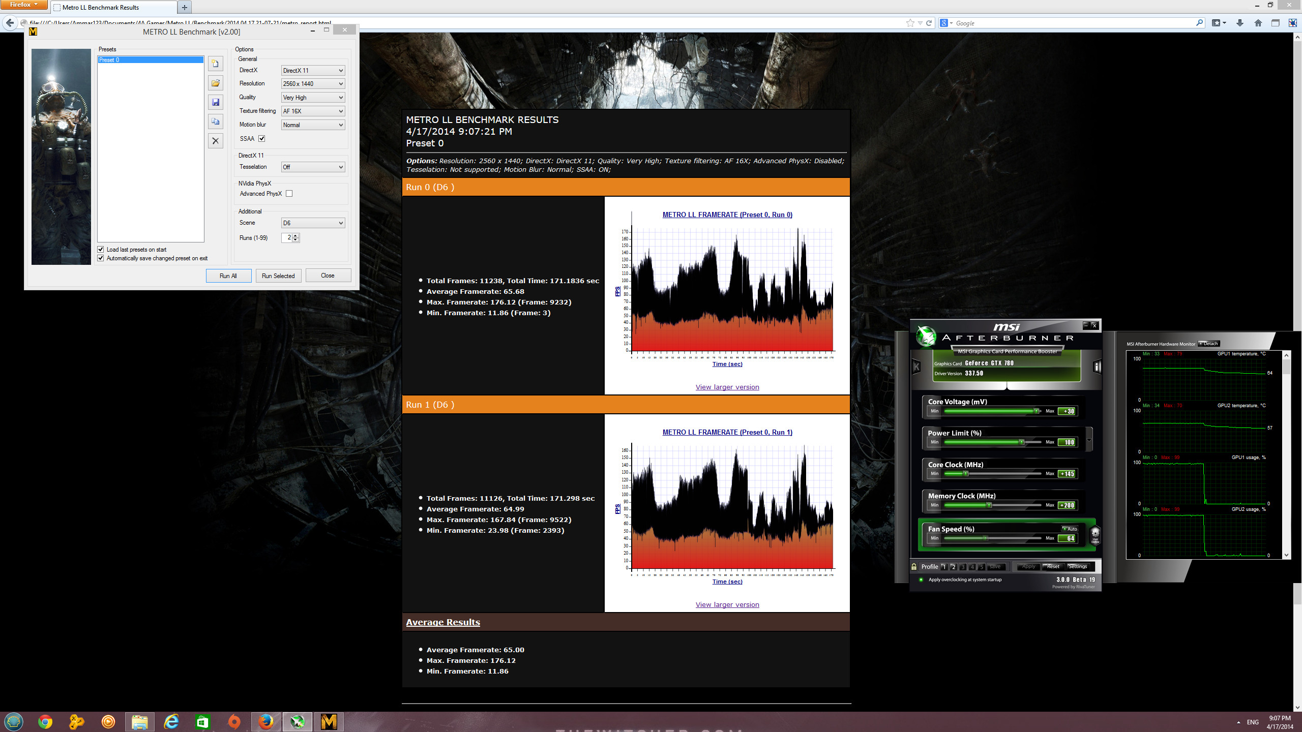

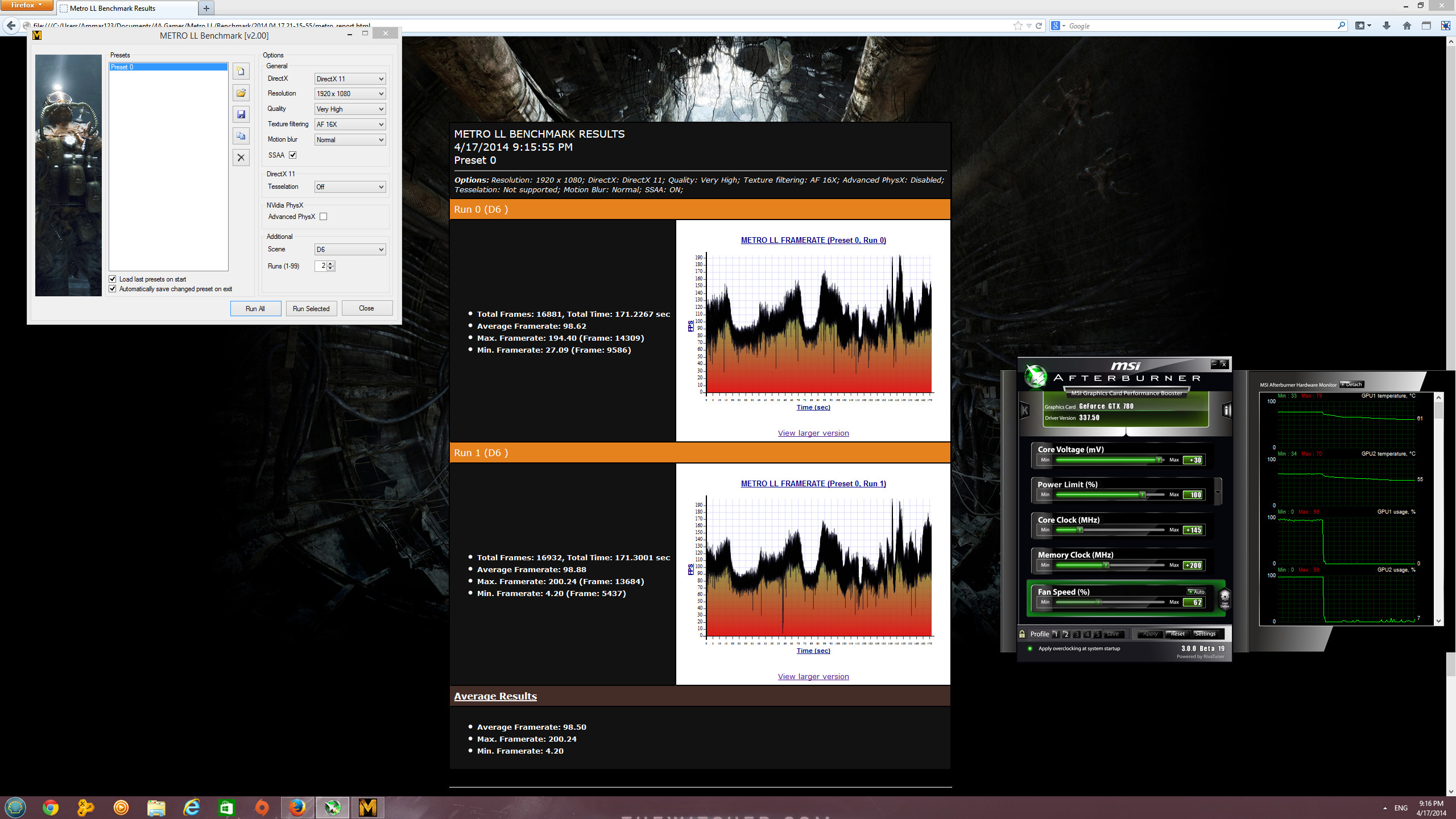

Here is Metro LL run again at 1920x1080, Tesselation off, and PhysX off. Everything else is same. So I'm the same as Desperado's first run.

This is Tesselation off at 2560 by 1440

so 98 fps for 780 sli and 3770k at 4.3 and 85 fps for titan black and 2500k at 4.3. even account for a few fps from 1080 to 1200 difference that is still huge difference considering desprado has slower gpus.

Hold on a sec. Lemme try to o/c these boys for a minute. BRB.
EDIT: Yup. Not much of a difference. Avg. only went up to 89 when I o/c'd the Titans 125MHz core and 100MHz memory.
I guess the CPU really is affecting. So if I o/c the Sandy to say 4.5 or 4.6 I should see gains far more than if just o/c'ing the Titans.
I'll give that a go.
