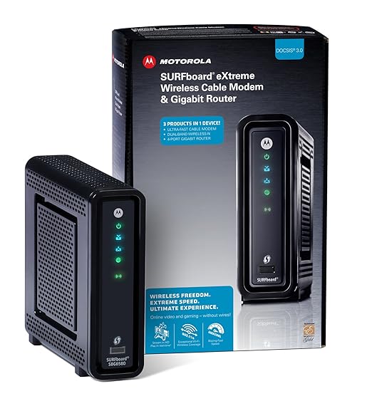

OK so i just upgraded my service to the 50/5 from time warner.
They gave me a Motorola 6850, and well.. its CRAP.
I wasnt getting anything near my 50... more like 20... which is sad because my docsis2 did 25.
Im giving u guys warning to this modem.
When i was provisioned it, Time Warner could not give me my 50/5.
I had to be escalated to lvl3 tech... and they still couldnt fix it.
Had to get a technician to come over and he took 1 look at my modem and went FOUND YOUR PROBLEM.
Changed it to the ARRiS brand modem, and now i get 51.8 / 5.1 :D
So if time warner decides to give u guys a Motorola 6850... ASK FOR ANOTHER ONE...
The motorola 6120 is a better modem then the 6850 from what that technician guy said.
This is CRAP:
This is not CRAP:
