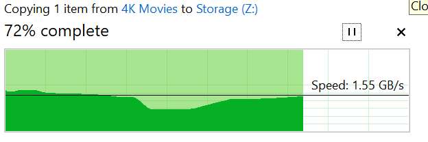

So, I've been playing with my setup and someone asked about TB P2P networking and since I have TB on 2 devices decided to take a stab at it before caving to 10GE Ethernet which would run me ~$300 for a NIC / TB3 adapter for the laptop. Figured a $50 cable between the two devices might yield better speeds for cheaper. The $50 cable is 10ft which means not having to get so close to the source of the data while copying things.
So, I tested the new cable and an existing 3ft option I had already and both link up at 20gbps and yield 1.5GB/s in transfers which is on par for the laptop doing an internal to internal between NVME drives.
This is going to/from Linux / Windows.
