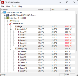

When I play CS2 LT/beta, I'm pretty sure my CPU throttles here and there:
Worrisome.
Cooler is a Noctua NH-D15S, with an RTX 4070 snuggled underneath it (high 60s C when gaming). Mobo is mATX, which is why I had to get the S version of the Noctua.
Should I bother reapplying thermal paste? I did the small bit in the center method, with the HSF and heat itself spreading it across the heatspreader.
CPU fan runs at full RPM all the time (~1500 RPM), so there's no problem there. And I'm fairly sure I have a bit of negative pressure in the case.
Short of getting watercooling or something, I don't know what else I can do here. Cramped parts means limited options.
