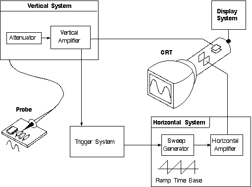

I thought it could be fun to start a thread with such information and to continuously update it with progress. Feel free to join in.
Background information :
http://www.hobbyprojects.com/oscilloscope_tutorial/oscilloscope_working.html
Basic analog oscilloscope :

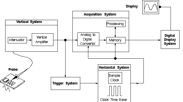

Basic digital oscilloscope :
To create a proper analog frontend of an oscilloscope, any old analog design will do of an old analog 25MHz/50MHz/60MHz or 100Mhz oscilloscope. Use some modern components in the design and it could be a good start.

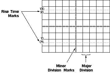

When wanting to make a digital oscilloscope, it is very important that there is a relation between the sampling rate and the timebase. We want the sampling rate as high as possible because then the horizontal (time)resolution increases as well, which makes it possible to see hf glitches in the signal. And we want a known preset relationship between the sample rate and the time base. This relationship is a compromise of maximum sample rate together with the available amount of memory to store the digitized signal we want to examine. The time base produces the horizontal sweep in an analog oscilloscope. In a digital oscilloscope it is also present but does not provide a sweep signal. It does however produce time information. The screen is divided into sections such a volt/div and sec/div. This is called the oscilloscope graticule. The time base adjust the value for the sec/div sections. The setting of the amplifier/attenuator section in the analog frontend determines the volt/div. As we will later see in another post, we also have to establish a relationship between the resolution of the analog to digital converter and the volt/div setting. The better(higher) the resolution, the more voltage level information we can capture.
