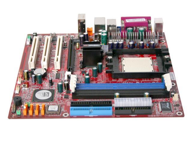

They can't do it and stay compliant with the ATX spec; the card's cooler will extend too close to the CPU.
Before breaking the ATX spec it'll break the mechanical outline specification of AGP cards. If you want proper airflow through an ATX2 case, have intake fans front bottom (and mid-rear if you like your graphics card and CPU extra cool), and exhaust fan in the top rear corner.

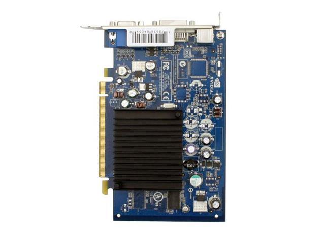

PCI Express cards have been "flipped" around so the GPU is on the top... haven't they?
BTW... the GPU is not the only thing you're trying to keep cool on video cards... there's RAM and the power regulation circuits also.
On most motherboards this would cause interference between the CPU and GPU airflow; anything you gained by heat radiating upwards would be more than made up by hot air convection from the cpu HSF, and the gpu HSF would contribute heat by radiation and airflow to the CPU.
Given how much better convection works than radiation, I'd imagine the net result to be both CPU and GPU temperatures increasing.
