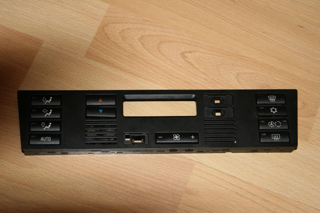

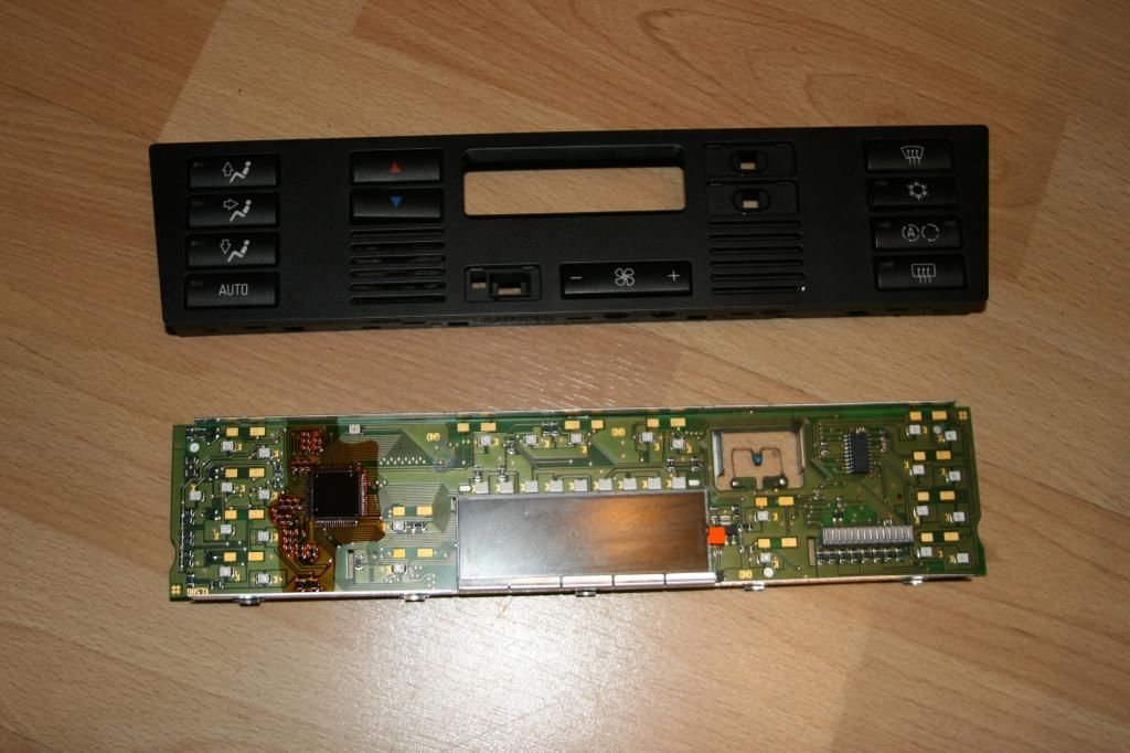

Today's example is my mothers X5. Now keep in mind, past few years I have fixed # of these types of things and they all seem to share similar flavor. Poor design and flaws.
This is a 2006 BMW X5 3.0. This is last year model of E53. Few years ago her Air control buttons started falling off (that's right, freakin buttons don't even last). Keep in mind my mom drives this car 20 miles a day IF that and the car is almost brand new (40k miles on it currently). She is 65 and hardly ever uses the controls.
Of course using a normal simple dial switch would be out of the question on such a luxurious car....right? Sorry, but I will take that ANY day over this crap.
http://i9.photobucket.com/albums/a82/passaturbo/BMW/IMG_9100_zpsffe2a05d.jpg
I bought the replacement part for 80-100 bucks and decided to change it out today. To pull out the console you simply unclip it from the dash (I used my nails, it came out easy). Sounds good.
Step too, unclip the outer cover (easy enough) and unplug the console (it's kind of shoddy as there is 10 pinns the slid out with no clip on the plug itself or anything. One has to be VERY careful putting it back as you can easily bend the pins/ruin the unit all together.
So next step is to take the metal plate out that holds the electrical board. There is 10 tabs and snaps out (pain in the ass). You can see the tabs in the picture.
http://i9.photobucket.com/albums/a82/passaturbo/BMW/IMG_9101_zpsd85fb5af.jpg

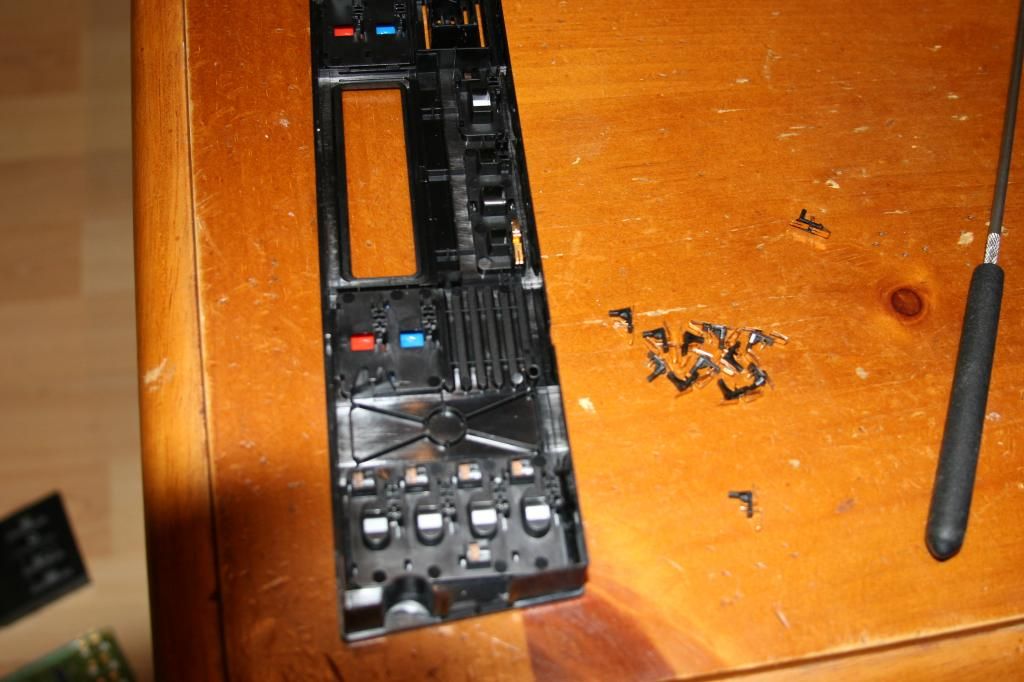

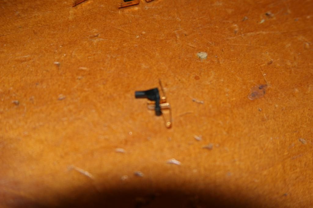

SO here is the fun part. Each and every button has these things.
http://i9.photobucket.com/albums/a82/passaturbo/BMW/IMG_9104_zpsc5e7a266.jpg
They are tiny and I had to use needle players to handle them. Of course each one has a metal bend on it that pops out as you remove the board (they fall out all over the place so one has to be careful). They couldn't be clipped in, no that would be too easy.
So one has to fix each one to make sure the little metal thing didn't snap out (or the button won't work).
Next step, put the plastic plate face down. You have to have something on the sides so that the buttons are not pressed in or each of these little pieces will pop out out of place. These DO NOT snap in. Here is a picture to give you an idea.
http://i9.photobucket.com/albums/a82/passaturbo/BMW/IMG_9102_zpsceeecfc3.jpg
http://s9.photobucket.com/user/passaturbo/media/BMW/IMG_9105_zps818ee935.jpg.html?sort=3&o=6
And here is the fun part. Once you have all the little things in there, I had to get 2 of my kids to hold the sides (so they don't slide around or buttons get pressed as the little things will pop out of place). Then you have to bend the plastic away to get the Electrical board into place. Once the board is in you have to slide it down into position.
It took us exactly 5 tries to do it right. As each time one or 2 button pieces would fall out of place and I had to take the entire thing apart/align the pieces and slide in the board again. As we were working on it I really thought I would never get it to work/fix it. In the end we were successful and finally got all the buttons to work. pfew
As we were working on it my 10/11 year old sons both asked "why didn't they do it this way or that way" which would've made this SO much easier to do/service. Since I have Mechanical engineering experience and used to design parts I could've easily came up with 2-3 different ways to make this easier.
I have no idea what BMW design team was thinking on this one. Heck it makes me wonder if they were thinking AT ALL!!!

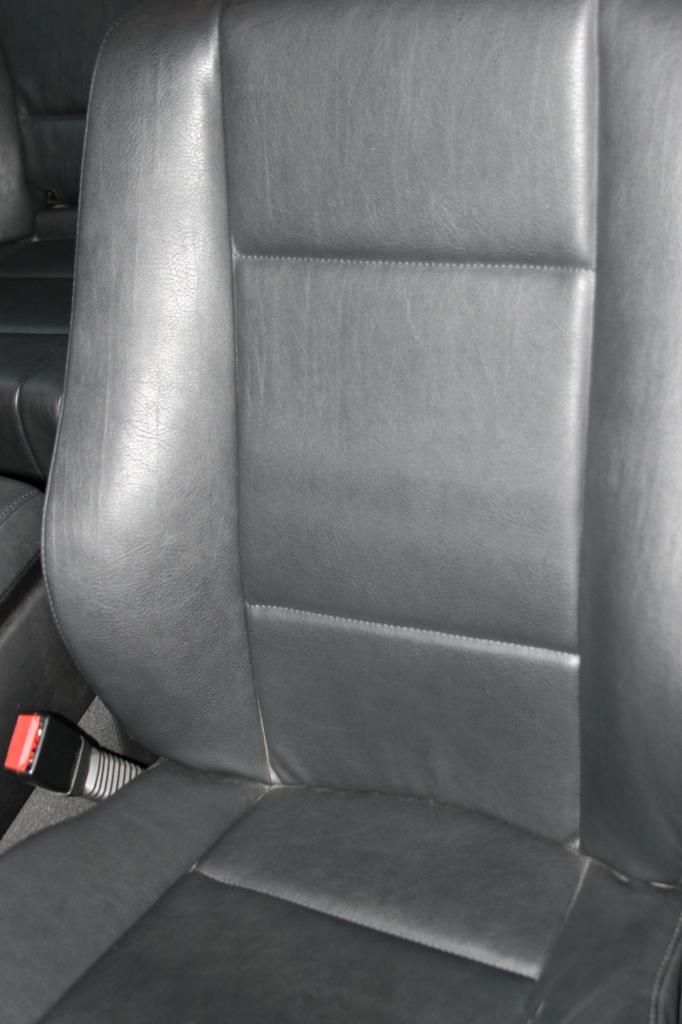

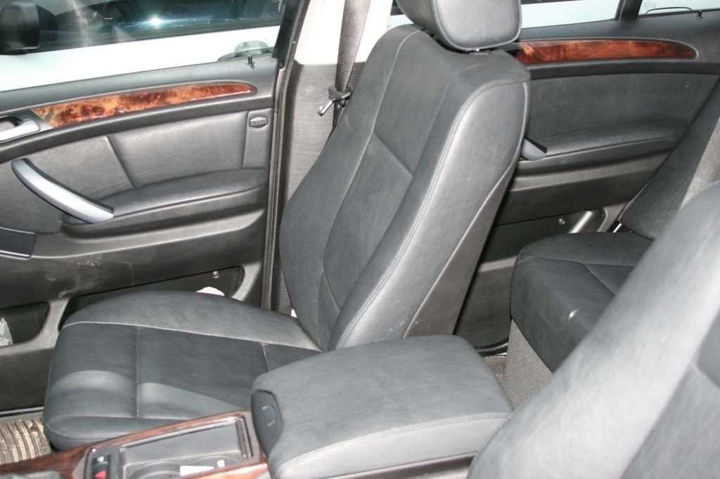

Also, I had a chance to take some requested pictures of my mother's cars leatherrete seats. This is by far my favorite part of this car, that's right, VINYL seats have held up AMAZING. They are 7 years old and they look brand new. 0 maintenance needed. I will NOT say this about REAL leather that my step father has on his 328xi....
THat's right I would take "leatherrete" aka pleather/vinyl over leather ANY Day of the week and twice on sunday!!!
http://i9.photobucket.com/albums/a82/passaturbo/BMW/IMG_9108_zps3700ff0e.jpg
http://i9.photobucket.com/albums/a82/passaturbo/BMW/IMG_9107_zps76a2304c.jpg

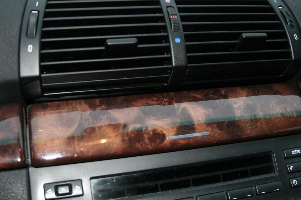

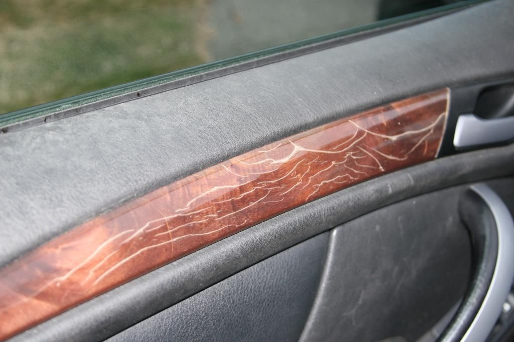

Also here is requested pictures of the fake/piece of shit cracked "wood"
http://i9.photobucket.com/albums/a82/passaturbo/BMW/IMG_9109_zps344467a2.jpg
THis one has a crack going across it but it's hard to see
http://i9.photobucket.com/albums/a82/passaturbo/BMW/IMG_9110_zpsadf4a37a.jpg

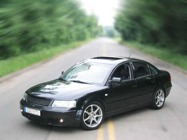

I didn't have too many complaints about my VW Passat.
Passat owner of 15 years :)....over 250k miles....
In general my passat has been reliable by Passat forum standards/German car standards. It also has been modified. It currently sits broken down (down to a compression test,I think it's time for an engine rebuild). I checked spark plugs, Injectors, infamous ICM, Coil packs etc......it doesn't idle well and it misfires at wide open throttle. It even has my mechanic stumped (he is a VW master mechanic of 18 years). Up next (when I care enough) I will check the compression......I just don't have money or time to throw at it. It is my baby though.
I had 2 over the years. One was totalled by some idiot that hit me from the back. So I took everything off and applied it to a 2nd one.
Passat#1

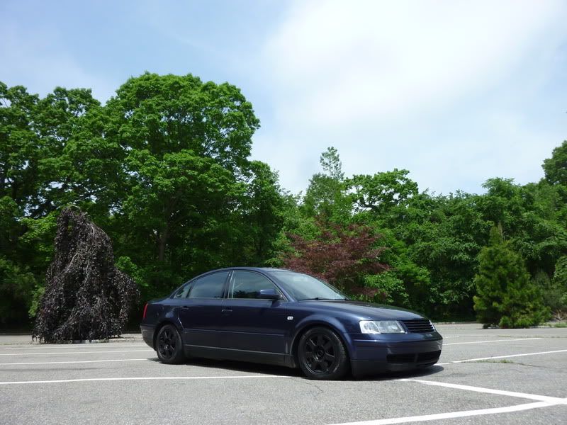

Passat#2
http://i9.photobucket.com/albums/a82/passaturbo/Passat 2/P1080275.jpg
But I've seen MANY Passat owners go thru some crazy shit as well over the years.....I consider myself VERY Lucky. :)
