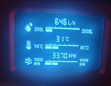

A good rule of thumb is to maintain about 1-1.5gpm of flow though your system, as that converts to about ~400W of heat with a 1degree change in water temperature from the hot zone to the cold zone.
Here is some statistics on my system.... although its near the upper ranges of LCS, but you can see i have a very high flow rate:
