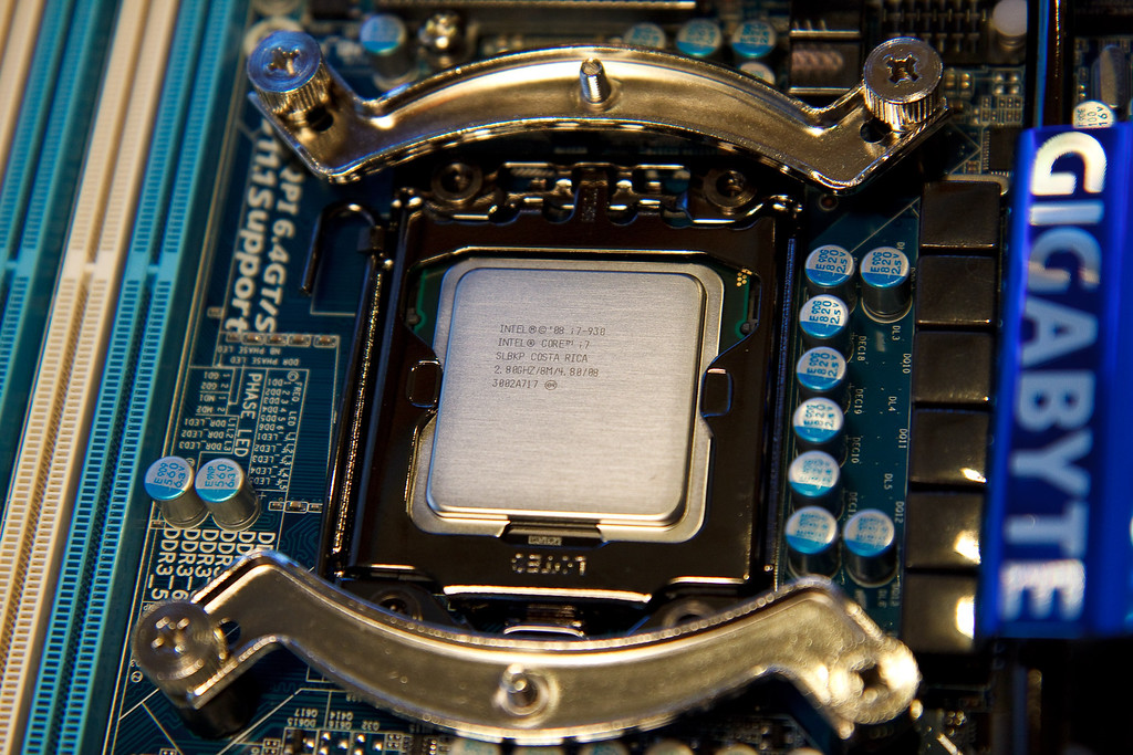

Doing my first processor installation ever, trying to to fudge anything up. I purchased some Arctic Silver 5 but realized there is already some kind of thermal compound attached to the stock heatsink of the core i7 CPU. I'm not going to be doing any overclocking until I upgrade the heatsink. Is the stock compound comparable to the AS5 or should I remove it and apply some fresh paste? Will I need to apply anything to the CPU if I just use the stock heatsink and paste?

Hello GCC, and welcome to AnandTech Forums.
The stock compound is not comparable to AS5, but is completely suitable for your purposes. How do you think the rest of the world (you know, the NON-overclockers) do things? Don't bother using AS5 until you get the aftermarket cooler and start overclocking.

Ok, even if there are particulates in IC Diamond, my experiences with the scratches or what I believe to be etching is really requires movement.
http://forums.anandtech.com/showpost.php?p=29822157&postcount=37
Is what I ran into after maybe 2 applications. This was within the FIRST WEEK of my i7. I returned it and RMAed it at Microcenter
Now I didn't think much of it later and ignored it, but after 1 year of use I disassembled my Noctua D14 to find this:
The serial is completely gone.
Here's the before:
Also while lighting can make the serial hard to read, I know for a fact the i7's serial is severely etched off. Also, I was building an i5 AND i3 system simultaneously this May when I disassembled my year old i7 to examine the etching.
That was my i3 or something and compared to it my i7 serial was impossible to read.
Now I understand that these compounds CAN have abrasives, but as someone who is working in the metallography lab to polish and grind to get nanometer smoothness for graphene growth, I tend to think it's not that easy for a HS to cause that kind of damage. You really have to put a lot of lateral forces on your CPU with your HSF and CONTINUE to rub back and forth to get any type of grinding effect. I was grinding copper plates on 200, 400, 600, 800, 1200 grit paper and that was more than a workout. Then going down to micron level stuff, you go to to the spinning polishing pads with alumina powder. Working with nanometer level, I'm using a vibratory polisher where the sample is in a slurry and the vibratory polisher kinda swirls it around on its own with a heavy metal holder giving it pressure. Unless you're suggesting my HSF unit is giving my CPU enough vibration to polish it, I highly doubt this is what's going on.
I'm not one to mount and remount my CPU. I've probably done 5 mounts TOTAL with IC Diamond 7. And that's split between the original CPU I got which I RMAed in a week. Sure in between I used MX-3 and AS5 for a day or two, but having used AS5 since 2002, I've never seen any abrasion or corrosion. IC Diamond 7 on the other hand was visible in days!
I mean you could think about it this way.... Put your hand on sandpaper. Lift and put your hand down again. Repeat 10 times. Now compare this to putting your hand down on sandpaper, rubbing it back and forth 10 times. Yeah, you can tell which one is far more damaging.
Overall I don't think IC Diamond 7 is bad. I just think there are side effects people need to be aware of. I could go all out and do SEM testing to see wtf is going on, but really? I'm not that interested in my CPU's IHS. It's still my TIM of choice for my main rig, but for anything else I'll stick to good old MX-3 which is DIRT cheap.
