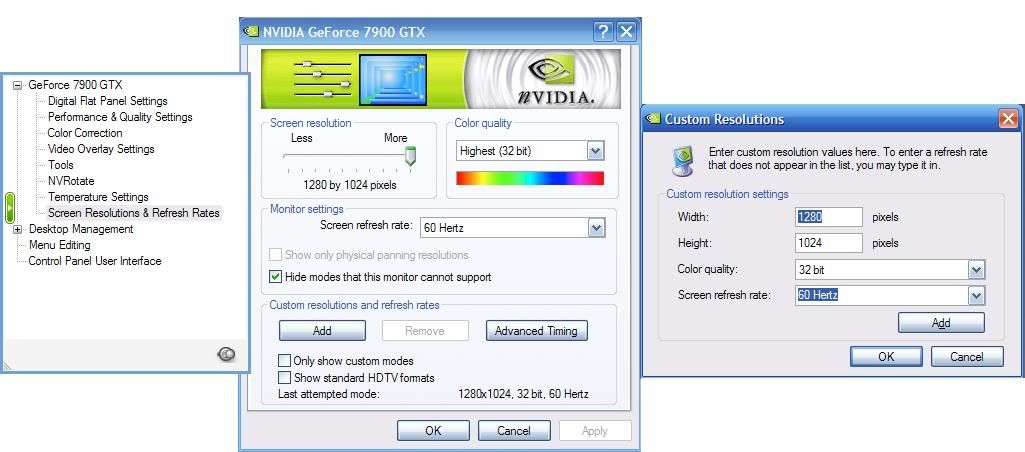

ghidu, have a look at THIS LINK to a picture of the control panel for my nVidia 7900GTX. As you can see, you can set any res you like as a custom res to choose from in the drop down menu.
Also, you graphics card driver will automatically pick up the supported resolutions from the monitor when hooked up.
