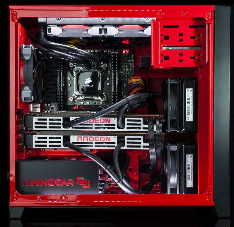

The second card will block off the center fan....What little airflow there is will be heated from the backplate....Vrms will sizzle. Cores wont care.

KaRLiToS
Jul 30, 2010
1,918
11
AMD stated 1 open slot required between cards. Read it it one of the reviews or AMD's site. Guessing it's for the vrm cooling.
Are you so sure? :hmm:
ViRGE

There are so many things wrong with that setup that I don't even know where to begin. The card spacing is a secondary issue compared to the fact that they're using the 295X2 rads on intakes. That's 1000W of hot air going into the case.:eek:

How can you tell its intake? The 120mm fan could simply be pushing air out the front.
I have a similar setup with my Nanoxia, all my rads are pushing hot air out, with fresh intake from side and bottom.
I would be concerned at the lack of airflow for the VRM fans, they already get hot at ~90C under load, definitely better to have an extra slot between them.

Indeed, the 3 Corsair Fans, the two top ones and the rear one are all intakes. Leaving only the possibility to have front exhaust. :colbert:

Judging by the placement of the fans all of the radiators are exhausts and the rear 120mm is the only intake. Its very rare to not use push and instead use only pull to move air through a rad. If they where all intakes every rad would be pulling air through instead of pushing. Not likely.
Also, notice that shroud has open. Slots on the sides which should all the fan some air intake. Probably not ideal, but also not blocked off.
The Top Rad and read fan are intakes.
Corsair SP fans can only have the colored rings on one side. And The Red Side is intaking the air.
Also, according to the 295x fan placement and radiator, the two are exhaust
This is pushing through Rad.
Very True, I noticed that too. ^_^

I'd choose another motherboard and case for this type of setup. One with the PCI-e X16 slots further apart.

I'm sure the radiator heat is exhausting out the front. My concern would be the fan on the second r9 295. How is it drawing ANY cool air to cool the VRM?
That's a good point that I had not considered, and VulgarDisplay seems to have answered it. Which means it's not quite as awful as it first seemed, but I'm not sure this is much better. The "right" way to do it would be to use a single 120mm for the CPU, and then place the GPU 120mms at the top and back respectively. This would allow cool air to be drawn in the front and out the rear.
Instead the system is already dealing with the hot air from the CPU before it gets to cool the GPUs. And that still ignores the close card spacing.:eek:
The 295X2 uses an axial fan. There's no real possibility of pulling in air via the slots in the shroud, as the only way that fan can move air is by pulling it in from the space on its intake side.. So those slots are for exhaust purposes.

Well the best way is to have all radiators push hot air out. Fresh air will be supplied via fans on the bottom and side panel, that way the entire system ambient is lower, no stagnant warm air. I know from experience because my rig mines 24/7 during the Aussie summer, we got up to 45C on a few days. lol

Almost all blower fan setups have the same "issue" (other card blocks the blower fan) yet they still run alright. It's not ideal, but it shouldn't lead to VRMs blowing up. Besides, the VRMs on the rear get hottest anyways and the extra airflow from the other card next to it's fan may actually help with that.
The 295x2 doesn't have a blower fan setup. The center fan is more like a traditional case fan. Looks to be encased just like a case fan. Maybe a tiny slot here and there.
The blower style fan has an advantage of being able to pull air in from the sides if you choke off direct airflow from the front.
Think about it.
No. Looking at your rig I'm guessing your more of a cooling guru than me.
I bet you wouldn't put a solid object in front of your case fans tho :)
See you beat me to it when I was searching for pictures. Visualizing it is hard for some.

I would really consider strapping fans onto the sides of the cards blowing through the slots if I wanted to really cool the passively cooled parts.
I totally agree with you that its not a good configuration.
But I wasn't trying to prove anything though. :p I was just showing that it was possible and that someone already did a sandwhich with two of them.
And no, I would never have a rig cooled like that. :sneaky:
