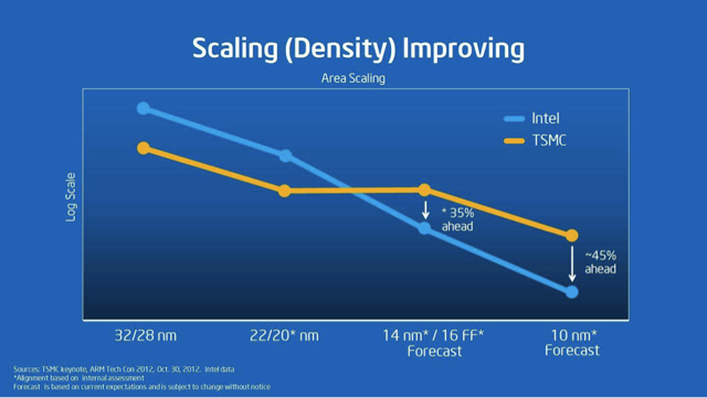

Yesterday I read an article (The Status of Moore's Law: It's Complicated) that states that the scaling of 22nm (from 32nm) was limited by the fact that Intel uses single patterning for the metal wires, while 20nm will use double patterning. So the metal layer pitch will be 80nm vs. 64nm, which is why Intel's 22nm isn't as dense as 20nm:
So that explains why Intel is aggressive on scaling at 14nm, going to a density of what TSMC would've called 16nm if they didn't take a scaling pause to implement FinFET.
TSMC 20nm and 16FF BEOL will have a 64nm M1 pitch. Intel is likely to offer a more aggressive M1 pitch @ 14nm given that this is what these numbers are talking about.
