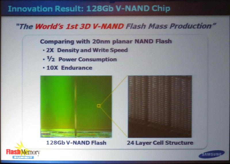

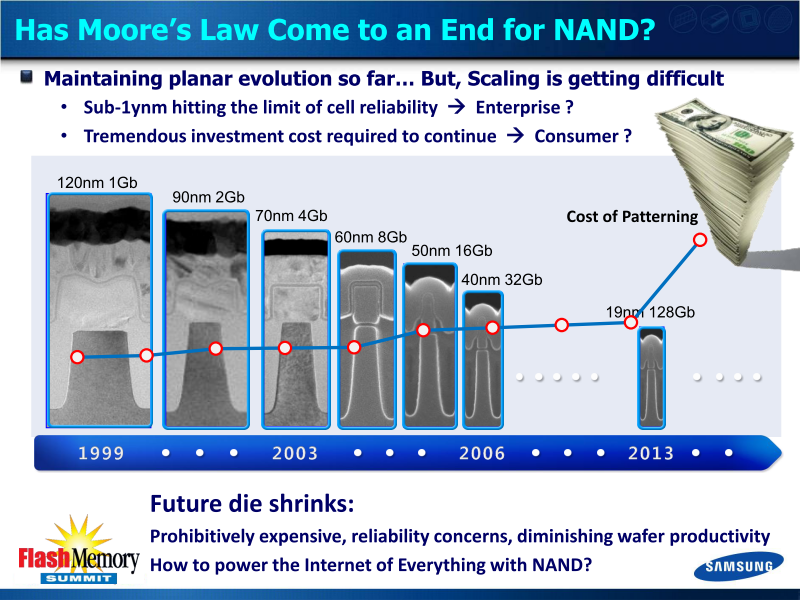

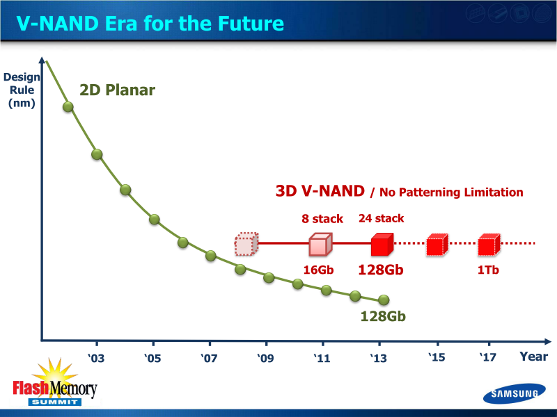

Checkout V-NAND :) It is not stacked chips or stacked wafers, but truly stacked transistors on the same chip.
Cool Samsung video here (definitely check out the video)
And slides from Goto-san.

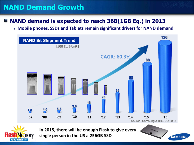

60% CAGR is a heck of a ride, and it is what pays for the ballooning R&D expense.
V-NAND will combine both linear scaling (just not as aggressively as in the past) as well as stack height scaling to lower the cost-per-bit for the foreseeable future.
The "vertical view" is a stack of 24 NAND gates, (rather impressive proof of concept stuff for the future).
Another nice cross-section view of the device which is already in production:
And what is the motivation? Money, naturally!
^ so long as the CAGR for NAND continues to grow at absurdly high rates (like the current 60%), the TAM will grow right along with it, and with the TAM growth goes the growth in economically viable R&D budgets.
Wow that is a truly innovative technique Samsung is demonstrating there. This is a very good representation of the direction scaling will need to go in the not so far off future. You can be sure it's something all the chip manufacturers are researching right now.
One obvious concern about this technique is heat buildup. Each layer is multiplying the current density for a given area of silicon so temperatures can potentially ramp quickly out of control. You'll need some very low power transistors for this to be a viable option.
