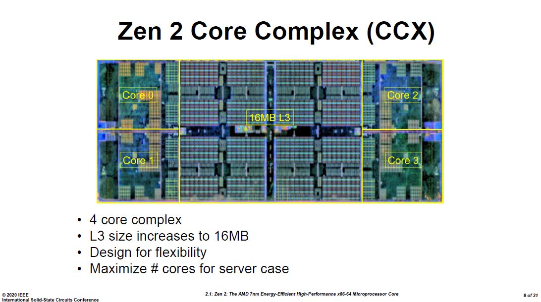

Incidentally, I found this link today. The article is in Japanese but the slides are in English.
Look at the bottom of the second slide, "Zen 2 Architecture"
it says "~9% switching capacitance (CAC) improvement over previous generation, technology neutral"
So that can give you an idea of generational (Zen -> Zen2) switching capacitance improvement. It doesn't say per instruction.. but it does say process neutral.
They go into more detail on the later slides, the "Generational Leadership Perf/Watt" slide breaks down the power improvements based on process and design factors. it looks to me like the majority of perf/watt improvement in this case is due to process.
Very interesting slides, thanks! It looks like AMD also considered interposer, but that would have limited CCD chiplet count to 4:
And where was that guy, claiming that chiplets will be replaced by monolithic design, as packaging is so expensive (but extra mask costs in million per each 7nm die are a sneeze):
Overall I really suggest checking these slides out, very informative.

What struck me when I first saw the slides was the increase in cost of higher die count CPUs. It's not just that it is cheaper to use chiplets, but that it becomes cheaper to a greater extent as the core count increases.
Meaning that until Intel goes to chiplets, AMD can squeeze them at will in higher core count CPUs.
moinmoin
Jun 1, 2017
5,243
8,459
Indeed, margin increases tremendously with the higher core counts. So for AMD (even ignoring the competition) it actually makes sense to push "ridiculous" amount of cores: 1) it increases their profit, 2) it increases their competitive edge, and 3) it makes software optimizations for more cores more likely to happen soon which again feed back into their competitive edge. The only limit it scalability of the hardware.
