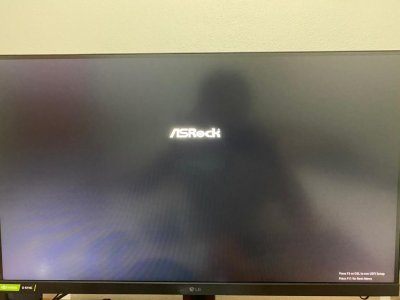

Hello friends,
When I shut down CSM, my computer gets stuck on the screen below and I cannot enter the BIOS or continue to Windows. Sometimes, when I don't use it for a long time, or when I turn it on after 1-2 hours, it happens like this, but the problem is fixed when I reset it.

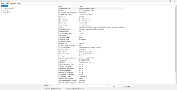

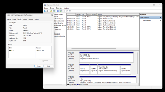

The BIOS version was 5.30, and I updated it to 5.70 due to this problem, but the situation did not change. I also switched from Windows 10 to Windows 11, but the problem persisted. The system is installed as UEFI, and the disks are formatted as GPT. If I enable CSM, I cannot activate AMD SAM, and Secure Boot must be enabled for Valorant to work in Windows 11, but Secure Boot does not work when CSM is enabled.
System: Asrock B450M Pro4 - 5700G - XFX 6750 XT - HP V6 RAM 1.4V 4133 MHz
How can I solve this problem? Also, would constantly resetting the computer at this screen be harmful in the long run?
