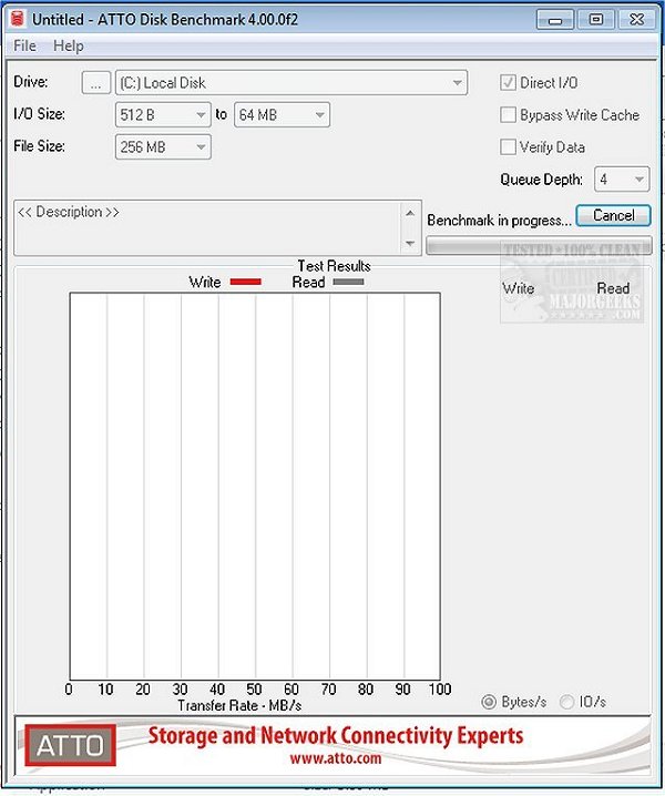

How did you determine this? Can you post a screenshot of a benchmark from this program (if you want my opinion):
