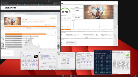

+79% improvement???? 😱
Dude, you should try out Alan Wake 2 benchmark if AMD bios has option to enable/disable AVX-512. If these guys used AVX-512 in 3dmark, maybe they used it in their latest engine too?

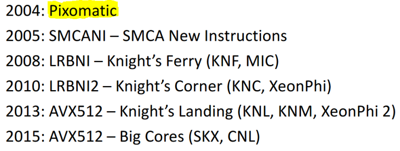

It's funny that AVX-512's need arose due to a software renderer: https://www.gamedeveloper.com/game-platforms/rad-launches-pixomatic----new-software-renderer
The 9950X's full width AVX-512 implementation is almost the 20 year anniversary of Pixomatic!
One wonders if Intel hadn't messed up AVX-512's rollout to consumer CPUs, we could have had a modern software renderer for games written in AVX-512, giving us the chance to enjoy Cyberpunk 2077 with Minecraft like pixelated graphics 😀
Maybe some day average Joe's 128 thread consumer CPU WILL run games in software mode at acceptable speed and graphics quality and we won't have to bother with a mandatory fat GPU anymore.
