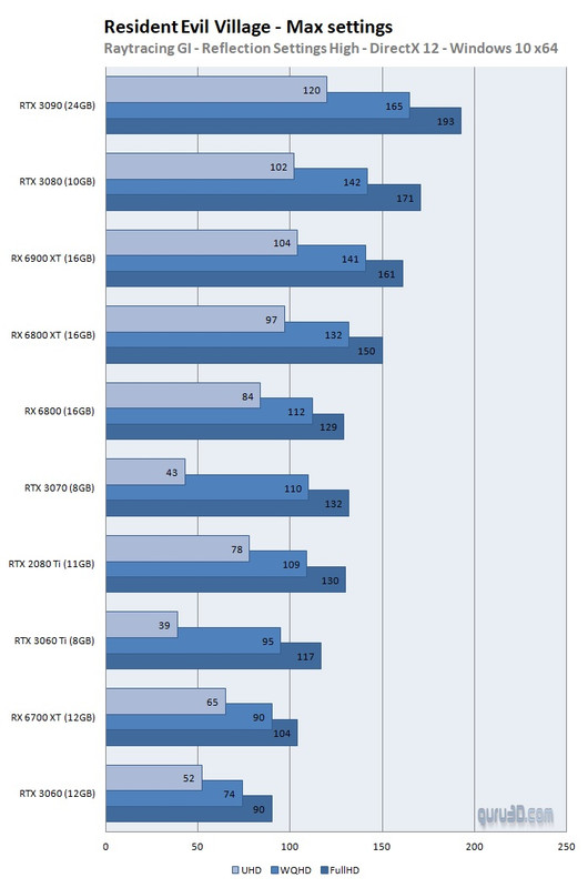

Resident Evil Village
3060TI/3070 tanks at 4K and is slower than the 3060/6700XT when ray tracing:

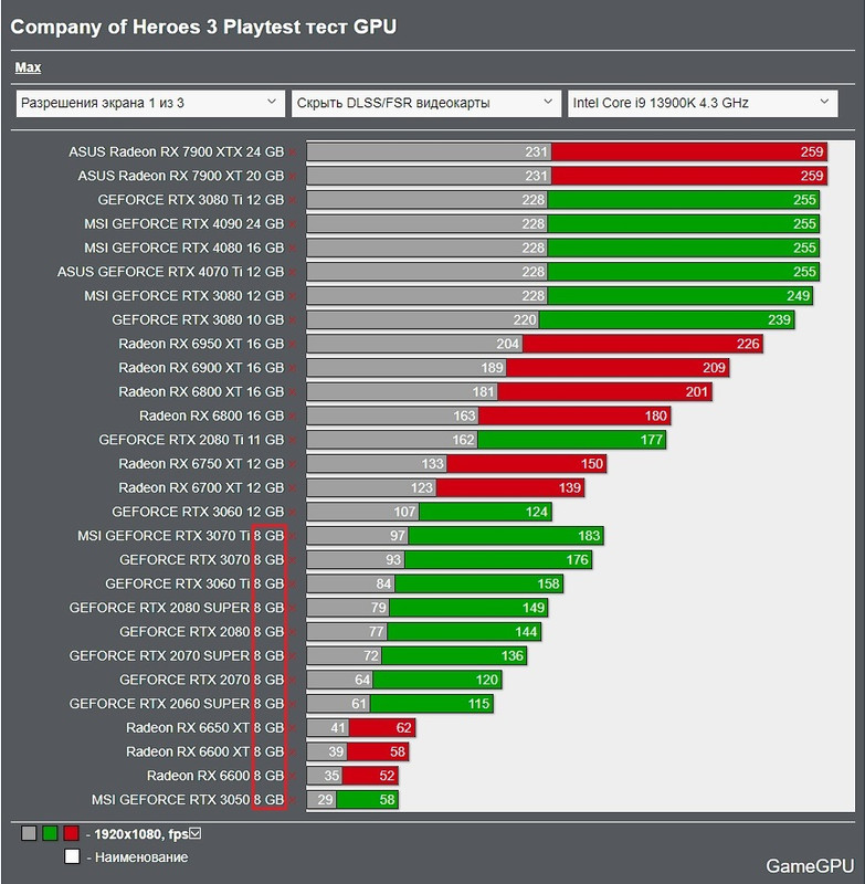

Company of Heroes
3060 has a higher minimum than the 3070TI, even at just 1080p.

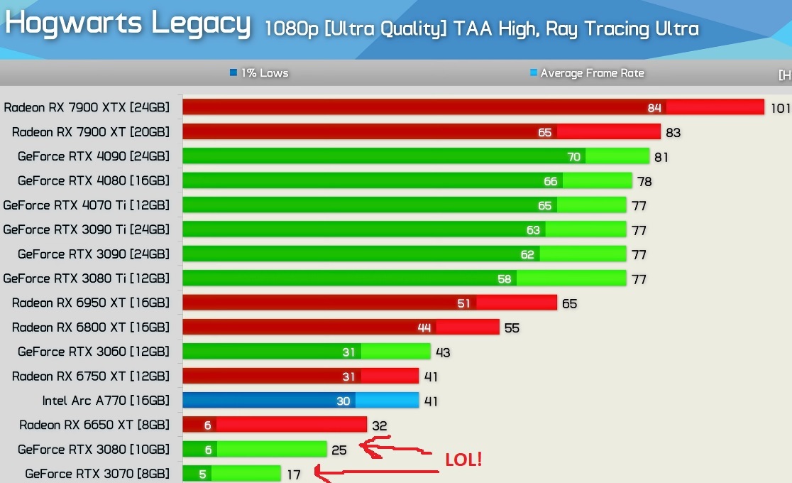

Hogwarts Legacy
At 1080p with ray tracing, 3060, 6750XT and even Arc is faster than the 3070, 3070TI and the 3080. Imagine paying $2500 for a 3080 in 2021 then 18 months later finding it's obsolete.
