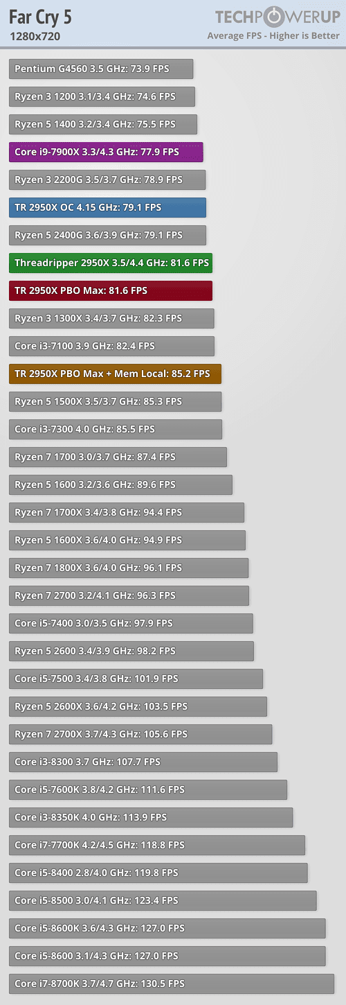

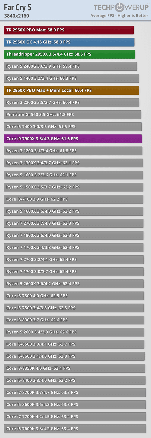

It seems Farcry 5 does have a performance problem with Threadripper & 7900x being ~65% slower than 8600k\8700k.
It seems its very sensitive to cache\memory latency.
AMD Ryzen Threadripper 2950X Review
https://techreport.com/review/33977/amd-ryzen-threadripper-2990wx-cpu-reviewed/12
But then this review doesn't look so bad with Threadripper at least competitive with 2600 instead of being 20FPS behind and only ~25% slower than 8700k which makes you wonder whats different.
Techpowerup at least claims this (they're real games, not 3D benchmarks).
So I would guess it's the difference in running the in build benchmark(wich is just a 3D benchmark) and actually playing the game.
https://www.techpowerup.com/reviews/Performance_Analysis/Far_Cry_5/5.html
On their GPU review of this game they state
We tested the game using actual gameplay, with the latest drivers for AMD and NVIDIA (which were released just a few hours ago). While a benchmark is available, it seems quite short and doesn't accurately represent in-game performance (the FPS results from the benchmark are roughly 10% higher than what you'll see in typical gameplay).
