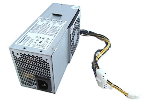

This is a 240W Lenovo TFX power supply unit! it is 7" X 3 3/8" X 2 3/4"

I do not know which are good manufacturers, so can anyone recommend a TFX 12V silent running and dependable power supply for my Lenovo P300 ssf. It is a micro desktop and currently has only a 240 watt power supply in it! I am currently changing out the fans in it, to a new quiet aftermarket cooling fans so I decided that maybe I should also get ready for a future video card possibly and to finish the silent project by adding in a silent power supply.
I know 300 watts is the standard but like to get a 350+ watt PS that is of a high quality! There does not seem to such a think yet unless I go and buy the Chinese 400. I think I will settle for 350 or even 300 for now. I thought of buying the Chinese 400 model and change the cooling fan to a quiet one but probably does not have pause reduce the fan speed function and better spec circuitry.
Thanks for any help you may be able to give me! I like to get the most powerful PS that is quiet and is dependable too!

Just got done replacing my Lenovo 240 watt power supply with a new Seasonic 300TFX power supply. What difference! Silent running. It quite shocking to heard almost nothing come from my P300 sff Thinkstation. The OEM power supply fan was making the noise; not the CPU(which I have replaced) nor the front intake fans which I have not replace yet! Very happy with the new power supply and new CPU fan!:)
I have added 60 more watts; so that I can upgrade to 1050 ti when they drop in price to where they should be with a lot of wattage margin to spare! I can wait it out!
