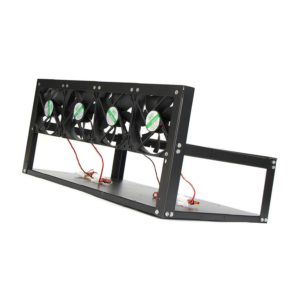

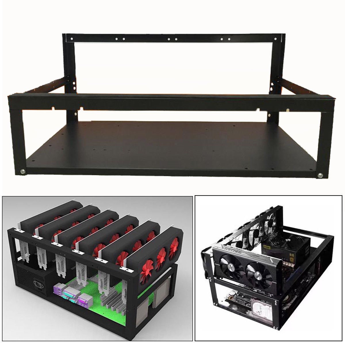

have you thought about just geting something like this and calling it a day using a normal fan controller?
https://www.amazon.com/xlpace-Minin...rd_wg=GcJdq&psc=1&refRID=XXJJRWFJ0K0QSZD4T0Z3
its probably cheaper then the cost of adreno + mosfets + all the other stuff lol....
Then you can just get some decent fans and just run them at 100%, and forget about using a temperature controller?
Since its open you dont really need to worry about static very much, it should keep your gpu's cool.
Also u dont need to worry about mounting and other stuff... personally it would save you a lot of time mickey mousing stuff to get it to fit.
Or you can get one without the front fan mounts... and just stack the fans ontop of the gpus:
If you really want and need a good fan, you can prop a 20inch box fan up front... :D
Tape a 20x20 MERV-2 filter on front of the 20 inch box fan, and you even got dust filter.
Theres a lot of open bench crypto cases out there which can hold anywhere from 6-12 gpu's.
I think it would be less of a headache to have one of those, unless u intend on something completely DYO.
