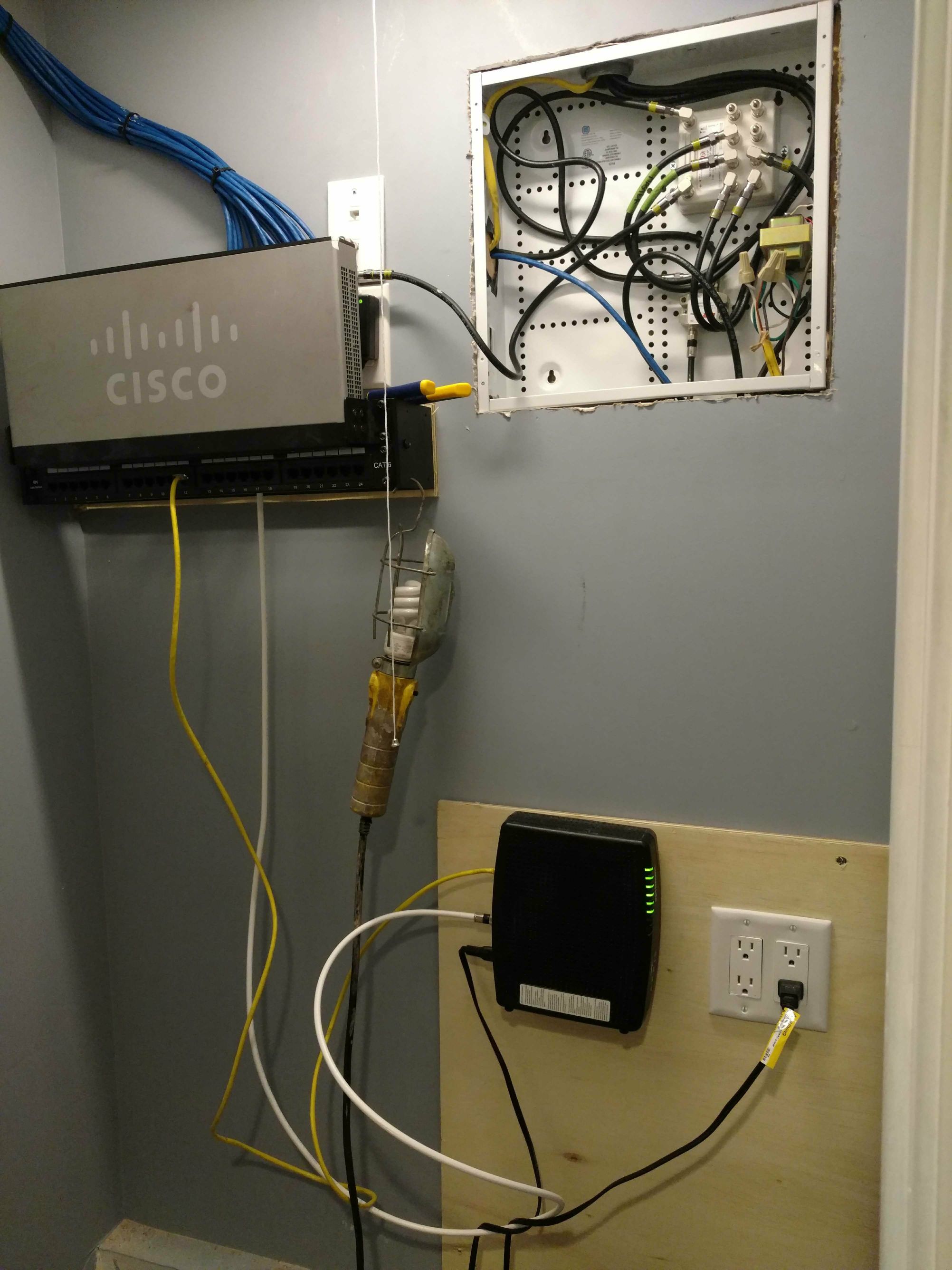

So recently my living room television blacks out when watching cable via Optimum, or streaming Netflix from the Blu Ray player. It only does this when the central air compressor kicks on.
Normally I know if they were on the same circuit this would happen with such a large draw to the compressor. But the AC units are on dedicated lines.
This is also recent, only AFTER doing some upgrading. I have a data closet that originally had one two gang outlet that was also on a dedicated breaker, cable entrance into home into standard splitter from Optimum.
I added a structured media panel which now houses a new powered coax amplifier, modem(moved from upstairs), Ethernet patch panel and switch.
I have added a surge outlet into the media box, an additional single gang outlet, and a light into the closet.
Sorry for the length but wanted to detail what I could.

Goes black, audio cuts out about 2-3 seconds. Sometimes just a blip, most of the time 2-3 seconds

Why do you have the AC cable wrapped around the coax?

Honestly, not intentional. Those wires still need to be cleaned up and dressed. Still a work in progress.

My first thought was the AC cords wrapped around the Coax into the modem as well. You could be causing some very interesting things if that coax cable is unshielded, but I would be surprised if it would be affecting the TV (rather than the internet).
Best thing to do is just start ruling things out. Go back to no splitter, then add the splitter back in, then connect other items, etc etc. Get an analog multimeter and watch the voltage on the main as the AC kicks on (digital might not pick up a very rapid fluctuation).

You're probably right but I have seen AC interfere with Fire alarm shielded circuits. Also is an end connection grounded? Not all EMI is reflected with the shield that's why it should be grounded.
signals.http://www.mouser.com/pdfdocs/alphawire-Understanding-Shielded-Cable.pdf

Well guys, it turned out to be that power cord wrapped around the coax. I separated it last night with no issues since.
That is also an optimum provided cable, so I will be terminating a new quad shield cable to replace it.
