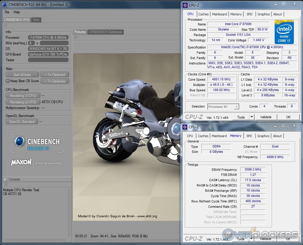

Now if you look here:
You'll see the 6700k getting 40731 @ 4.8 GHz. That's ~1060.7 per thread per GHz. Here we see two interesting facts: First, XV is very close to the 6700k in this old SSE2 benchmark, losing by the margin it does thanks to AMD being unable to clock it very high and deploy more modules. Secondly, a 4c/8t Zen should require only a clockspeed of ~3.8 GHz to match the 4.8 GHz 6700k in R10.
Haswell-like performance? I think not.
SMT performance is only about 30% better in cinebench. With 4 cores/4 threads that Skylake would be around 30k, which makes its score above 1500 per thread per Ghz.
Indeed so.
40731 * 0.7 = 28511.7
28511.7 / 4 = 7127.925
7127.925 / 3.8 = 1875.77
So 1875/core/GHz.
