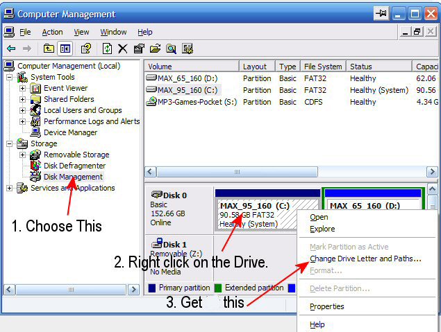

i have a really annoying problem with windows that has to do with windows automatically assigning drive letters. i originally had two hard drives in my computer, the primary master 160gb and the other hd 80gb. the 160 was divided up into three partitions: c,d,e and the 80gb: f,g,h.
the load on the 160gb hd started acting funky so i decided to format the drive. i installed windows and divided it into three partitions. when i was done installing, lo and behold i found windows had assigned the drive letters h,i,j to my newly formatted hard drive.
how can i prevent windows from doing this? i want to restore it back to how it orginally was with partitions c,d and e assigned to the 160gb hd. i have already tried to remove the slave in the bios but windows still see's it :|.
ps: physically removing the 80gb hd would not be an option because it would create too much of a mess to rip out my computer guts.
thanks.

"windows doesn't allow you to change the drive letter" [of the drive the OS is installed on]
That is correct.
Sounds like you need to reformat/reinstall.
BTW, as for the idea of disconnecting the 80GB drive. If you need to do that for some reason, you need only temporarily unplug either the IDE cable or the Molex power plug.

This is mostly correct... I have found that some motherboards will not like it if you have an IDE cable pluged in to a drive with now power.
I had this same problem when I set up windows once because I had a card reader installed. It saw those as drives first and put my system drive as g:. It was annoying. The only way I could really fix it was to unplug my extra drives and install Windows. Then, I hooked up the other drives and everything was just peachy.
