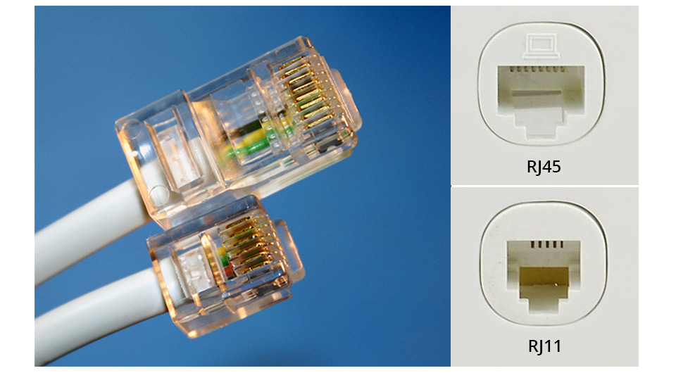

The cables are different too, RJ11 is flat (common color, beige, grey & black) and ethernet usually is round. Flat ethernet cables are very common now, however.
RJ45 - Ethernet, 8 pins
RJ11- Telephone, 6 pins
