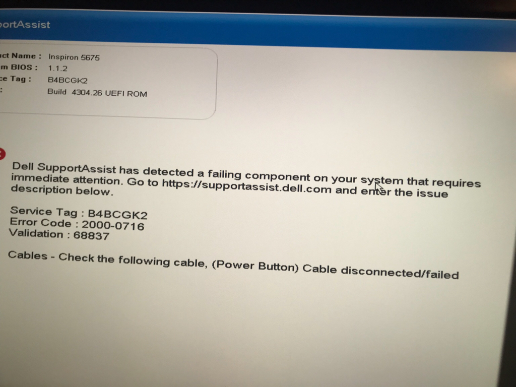

Things went a bit wonky last night. Got it running once and noticed smoke. Turns out the USB 2 branch of my front panel USB cord was melting. I had the USB 3 portion in the old case spot for a front card reader.
Swapped that, then it would run but no signal to monitor. Took the GPU or and in, and things were working other than I get an error message from Dell telling me my power cord is defective (see pic). Guess they don't like me using another case.
Not sure if this is actually a problem or just an annoyance during startup. Maybe I can dismiss it permanently somehow?
Other option would be to use the old power switch cable and have it sticking out there back of the case or something. Wish I could splice the cords somehow but that would end badly I'm sure.
Thanks!
