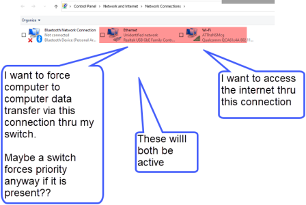

I have 2 computers that I connect using Cat5 through a switch so that the computers can share folders etc. I get great speed using this switch arrangement ( terrible speed if going thru a Wi-Fi network) , BUT I need to be able to have each computer use its Wi-Fi to connect to the internet via a wifi broadcasted signal.
How do I force the computers to "talk to each other" using the LAN/switch, BUT access the internet using their own Wi-Fi connection to my central router that is broadcasting the Wi-Fi signal?
It seems that I have 2 networks when I look in my Win 11 settings - one for the switched LAN, and the other being the Wi-Fi network. How do I make sure that the computer to computer connection is thru the switch, and not the Wi-Fi, but still get internet access via the broadcast wireless signal?
I am concerned that the computer to computer data transfer/folder sharing et, are connecting thu the Wi-Fi even though I have the switch. I want to prevent that use of the wifi for the file sharing..
The reason I want to do this is because if the computers use the Wi-Fi network to share files, the transfer and processing rates are very slow. Thus the switch for speed. The computers need internet access on a sporadic basis, but need the computer-to-computer data transfer operations to happen "all the time".
Want to force use of switch for computer to computer folder sharing, but use the Wi-Fi for internet.
Advice?
Sorry for my bad use of terms, but I hope you get the idea.

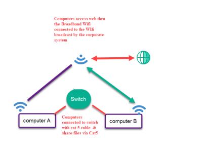

Put the different ports on different networks. Let's say that you use 192.168.1.x for the wired connection and 192.168.2.x for Wi-Fi. The 2 PCs can only talk to each other over the wired connection at that point since the Wi-Fi is on a different subnet.
Just to make sure, I post the diagram below and I think that that your suggestion would make this happen, right. I do not have control over the corporate network.. For example I have 2 computers and I am at a hotel or at a corporate office and using their guest wifi, ,to access the internet, but need to connect my 2 computers to share files without going through that wifi network. Pretty much thumbs here on all this ( as you can tell) .
I do have a switch that connects them automatically, and I am able to share files, but when I activate the wifi on each computer, to get to the internet on them via the broadcast wifi, I think the sharing is going thru the wifi right now.
I can somehow manually set up the ports?
When you connect to a public Wi-Fi Windows should turn off file sharing for that network if you haven't changed those settings. So file sharing could only occur over the wired connection as long as that network is set to private.
ill check it out.. Thanks
The detailed steps that I found that follow along the lines of the answers posted. For some reason I had to set the last digits of my 3 LAN connected computers to x1, .x2 and .x3. Things did not work if I used .192.168.10.1. 192.168.10.2, 192.168.10.3
Had to use 2 digits at end :
192.168.10.11,
192.168.10.22,
192.168.10.33
