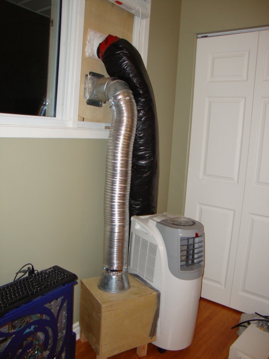

The twin pipe will be more efficient, so it will help, get the biggest one you can, mine is 1 ton (12,000btu).
I converted mine to dual pipe:
Though I'm getting central A/C soon so I can stop using it. Downside with portables is they're loud. I'd compare it to having a blow dryer running behind you, except at a slightly lower frequency so not quite as bad. You can't watch TV or watch videos or anything like that if it's in the same room, and even if you're a heavy sleeper or need a fan to sleep, this is louder than you'd want to try to fall asleep with.
It will cool a place decently though. Sometimes I leave it on when I leave the house and when I come back I can actually notice the house being slightly cool. I have it point towards the hall and that's where one of the return vents is, so I'll just run the furnace blower to circulate the air.
