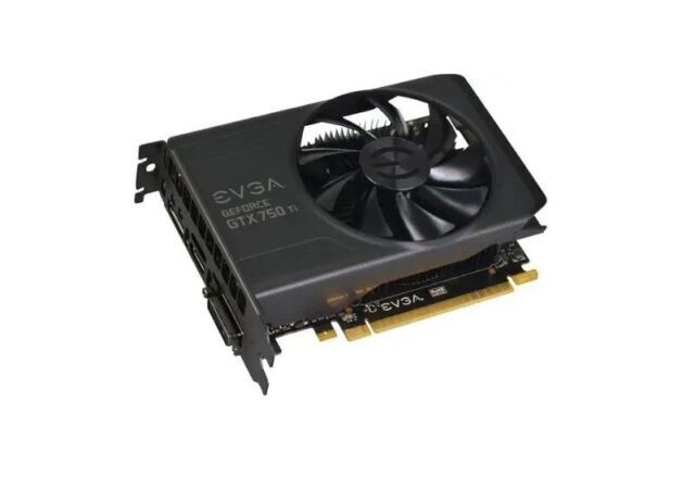

The video card that came with my z420 is dying with screen artifacting and randon black screens. I think it is an AMD 7470. Since it's an OEM workstation card so not much labeling but it looks like model C264. I replaced it and the artifacting went away but it occured to me that none of the random video cards I have laying around support 4k and/or have Windows10 drivers. I can't get anything about 1024x768 resolution with the old AMD card I threw in since Windows is using generic drivers. Any suggestions as to what to replace it with? I don't want to spend a lot of money. It doesn't have to do anything but allow 4k video to play. It already has AMD drivers installed so an AMD card would be make installation a little easier

Your CPU can undoubtedly brute force 4K without help, so you can use a super cheap display adapter that doesn't support VP9 or AV1 and be fine if you don't want newer that supports both. Even something like this R7 430 for under $12 would get the job done. --- R7 430 2GB on Ebay

There so many of these low end GPU's, sorting through them is a problem. I decided to get an R7 450 cost about 10 dollars more than the R7 430 but has both an display port and HDMI outputs.

Installed and 4k is up and running. Didn't bother with drivers might later but not sure what I would need them for.

Wow you coming from the older Caicos 7470 (rebadged 6450), almost anything would be an upgrade to that. If you want up to HEVC/H265, which I would recommend as minimum, something like Radeon RX 550 4GB (OEM or other) will do fine but avoid the 400 series because some variants do not fully support HEVC/H265 decode in hardware and you have to kind of dig to find which. BTW the Radeon RX 640 4GB (OEM) is just RX 550, slightly different clocks. As is the Radeon Pro WX 3200. All are Polaris.
For NVIDIA, 2nd gen Maxwell (not 1st GEN!) is minimum for hardware HEVC/H265 decode. Pascal is the minimum for VP9 support. Not sure about AMD and VP9 but I think the min is Navi.

Also why not 2nd Gen Maxwell? According to NVIDIA it supports HEVC/265 (but not 1st gen Maxwell).
Edit: well it seems only *some* 2nd Gen Maxwell parts (with 2nd Gen NVDEC) support it, not others. e.g.
Support HEVC/265
GeForce GTX 750 / GTX 950 > 960
GeForce GTX 965M
NOT support HEVC/265
GeForce GTX 745 > 750 Ti
GeForce GTX 960 Ti / 970 / 980
GeForce GTX 980M / 980MX
GeForce GTX 980 Ti
GeForce GTX Titan X
Wow, what a mess, like the AMD 400 series.
