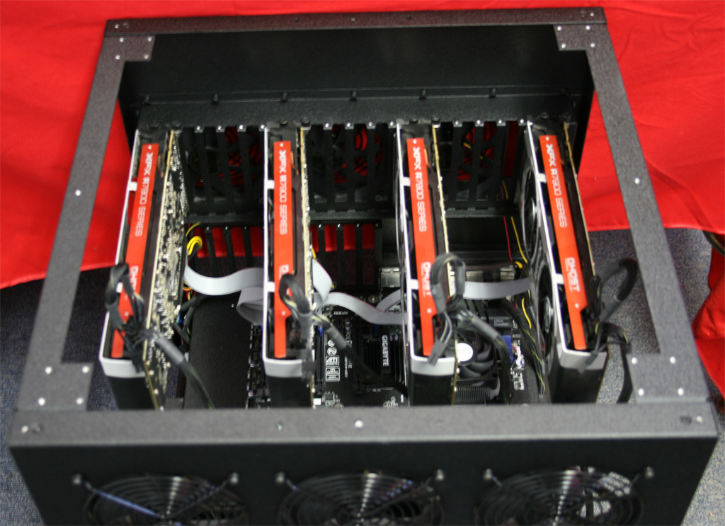

The Gold Digger Case from Mountain Mods, would most likely be ideal for 4 x GPU's.
http://www.mountainmods.com/ascension-gold-digger-gpu-mining-case-p-725.html
You would need to get a 16x PCI-E Riser for that system also.

The Mountain Mods case looks interesting, but the design seems a bit older and larger than what I need.
