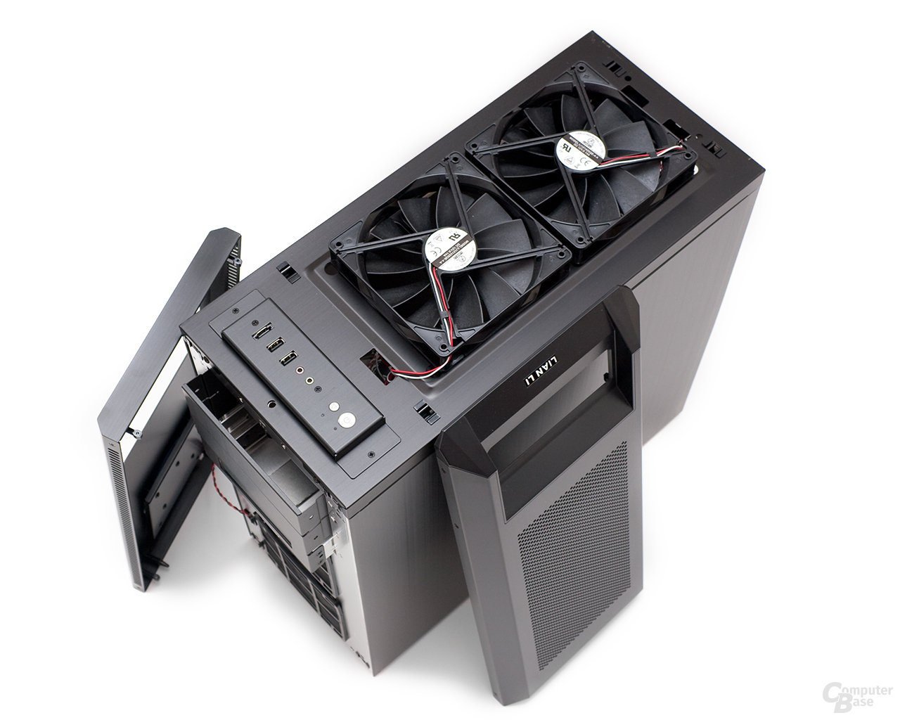

My case is oddly designed. The 2
140mm fans on top are mounted on top of the internal cage with a removable top cover placed over it.
This picture should help. That's the top leaning on the side of the case with the words 'Lian-Li'.
It doesn't look like there is a lot of space between the front fan and the 3.5" external drive bays but if there was some way to attach the radiator to the fans I think it would fit. Unfortunately, I don't see how I could attach the radiator to fans.

EDIT: I added a picture taken from the inside looking at the top and rear. You can see the 120mm fan on the back and how the top fans are mounted. I think there is enough room for a 120mm radiator mounted on the rear of the case.
If I've got 2 140mm fans on top I think I can draw air into my case from the outside to cool the CPU radiator and then use the 2 140mm fans to pull the hot air right out of the case.
That would definitely be a thight squeeze. You might be able to fit it if you removed your rear 120mm fan, though anything in the 5.25" bays would interfere with the rad too. The fact that the fans are raised on a beveled part of the case and the metal rail next to them inside the case makes me think that it wouldn't fit at all. Though that's mostly guesswork. I'd say you shound go for a 120mm rad and fit it in the rear. From what reviews I've read, the Arctic Freezer 120 should be on par with the h80i for slightly cheaper. Don't know about AM4 compatibility, but then again Corsair's AM4 brackets are delayed until mid-april or later.

Looking at other sources of pictures in a Bit-Tech review, it appears to me that that a push-pull with a 35mm-thick radiator would only obscure the upper part of the motherboard, without interfering with it.

Here's what I'd do with that case -- The Lian-Li B25. This from someone who has yet avoided buying even an AiO cooler. The ubiquitous rear exhaust fan -- almost too close to what would be a 240 radiator and possibly push-pull fan assembly, would become intake. I'd put a box around it and mate the box with a motherboard plate. This would force air over the motherboard and even the waterblock -- you'd have to cut the plate in places so that you never needed to perform hose-removal in for removing or replacing the plate. There would be another front-panel intake fan.
Then, I'd march down to the local metals store on the other side of town and its industrial zone. I'd buy either "perf-" steel or aluminum, depending on the case-metal. I'm just guessing the B25 is SECC-steel, but Lian-Li seemed to produce a lot of aluminum cases to my memory.
I'd cut a rectangle and cut the corners from it to make a stubby cross, and neatly bend the resulting tabs which have a width identical to 50mm+radiator thickness. The resulting rectangular box would have tabs with mounting holes -- like little feet. I would tap holes in the case for 6-32 thumbscrews, unless the less-noticeable hex-head is preferred.
But you'd have to cut away the perforated part of the top-panel fan vent. And that's the big decision if you bought the Lian-Li case brand new. Maybe there's a way to get around that with an acceptable result -- I can't say.
