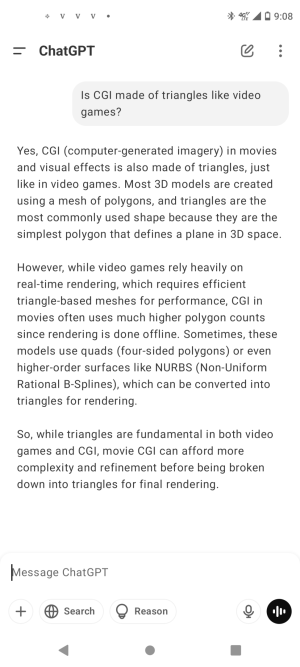

Gizmo j
Nov 9, 2013
1,752
458
This is actually one of the less stupid questions you've asked.
No, not necessarily. There's many techniques for making CGI, most of which I'm unfamiliar with, but I know enough to know they're not all (or maybe even any, anymore) triangles.
