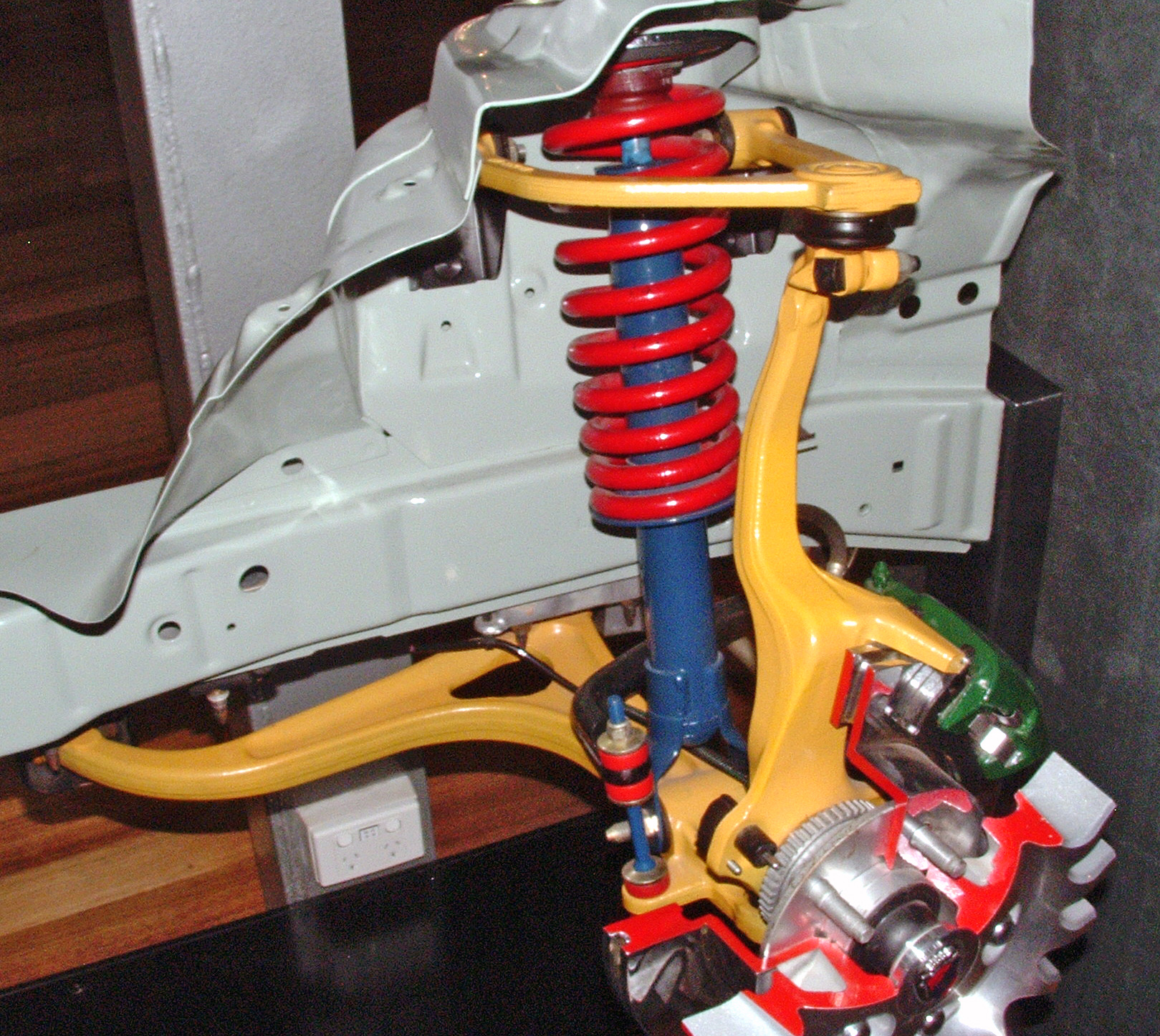

The technical definition is that a strut is an integral part of the suspension (i.e. it is helping to hold the suspension together). The MacPherson strut setup is the most common example of this. If you remove the strut from such a setup, the whole suspension falls apart basically, because there is no upper control arm.
In a double wishbone setup, the shock absorber/spring assembly is not an integral part of the suspension, as the suspension geometry is determined by the upper and lower control arms. In this case, the shock/spring assembly should be called a coilover, not a strut. If you removed the coilover, the wheels would still stay perfectly attached to the suspension (the suspension would simply drop to its lowest point).
Here's a good link to explain the difference:
http://www.1aauto.com/content/articles/shocks-and-struts
