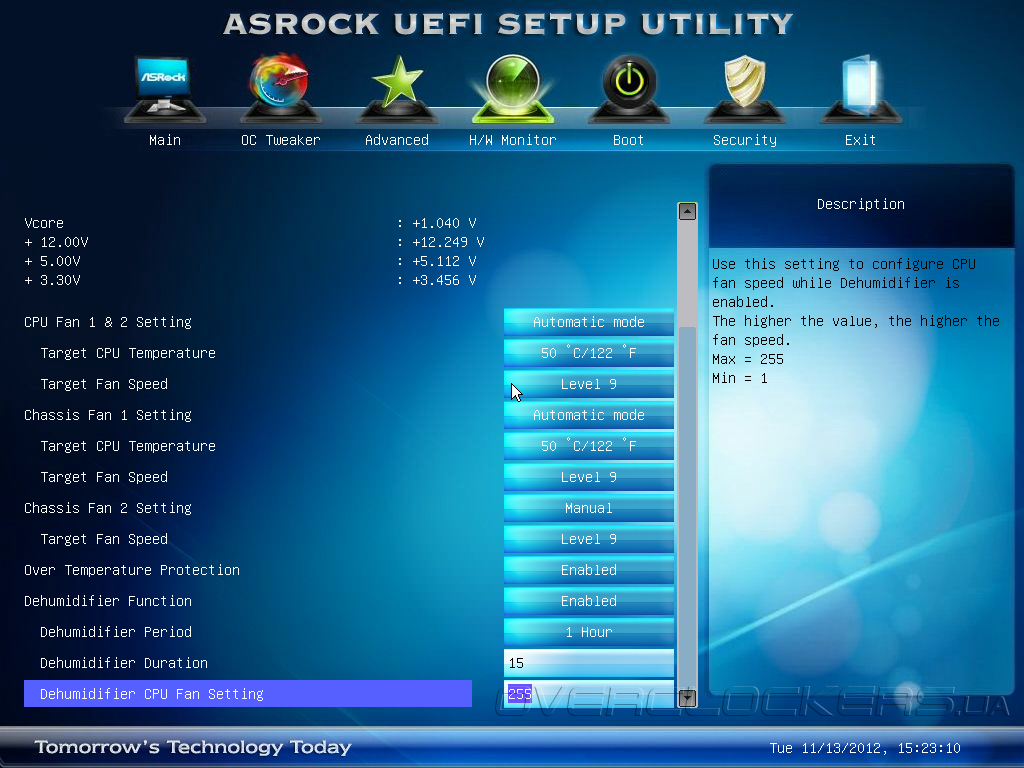

I use the Evo 212 on my cpu because the stock cooler on my 2500 would shoot from 2000rpm to 3000 under load and got very noisy. With the 212 heatsink the rpm seems to be at 1200 all the time, full load and no load, despite any settings I try. To be fair the evo at 1200rpm is still far quieter than the stock sink, but it's still kind of loud. My i5 2500 is locked and doesn't get an overclock outside of Turbo. It's around 25c at no load and about 38c at full load. I clearly don't need the evo 2012 spinning that fast to keep this puppy cooled. I would happily let me cpu hit 50c or even 60c under load if it meant I could lower the heat sink rpm to 800 or so. I only use the intake fan that came with the 212, I don't use an extra one for push/pull as I figure the quiet 120mm case exhaust can handle it. Things I've tried so far:
-Downloaded speedfan. It gives me great readouts and can lower the GPU fan but not the heatsink. (which is strange because it let me lower the stock sink rpm before it was replaced)
-With software failing, I figured it was up to the bios.
http://www.overclockers.ua/motherboard/intel-z77-asrock-pro3/31-big-asrock-z77-pro3.png(not mine, but a bios pic for comparison)
No matter how high I set the target temp or what I change the target fan speed to it's always spinning at 1200rpm.
Any suggestions?
What options do you have at CPU Fan Setting besides "Automatic mode"?
It may require an unintuitive setup in which you set the fan setting to something like "Manual mode" or something else available and then set the appropriate target temperature and fan speed. It will still be an automatic control, but based on manual settings :sneaky:

dumb question, but do you have the cpu fan plugged into the correct fan header? have it set correctly for the fan (PWM/voltage controled ect)?
That's the fist thing that comes to mind, because modern boards have up to 4 fan headers. Your board has 1x 4-pin CPU header 1x3 pin (CPUfan2) and 3 x 3-pin chassis headers. And they are right next to each other.
Under which name is CPU RPM reported.
The other thing is that modern OS/Software often overrides BIOS settings, so if Asrock's Axtu is set to load at startup, it will always run at whatever RPM is pre-set in. You can either set things here, or in bios .
There are two check boxes that make all the difference.
[ ] load on Startup and
[ ] auto apply when program starts
