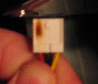

UPDATE: pic of burnt pin: HERE

here's a picture of the burnt pin..sorry for the blur..my cameras not good at close ups but you can see its bad
burnt pin

The burnt pin isn't anything other than lack of physical contact between the two mating parts (i.e. male and female pin). I would check the plugs on both mating parts and see if the female plug is too spread out to give <50% contact and make sure the male plug isn't smashed down where it would be the same way. The item that this was hooked to might have been damaged by the voltage variance that the arcing could have caused. This isn't a power supply issue though.
edit: A short in the part or the wire would have made a noticable change in the wiring like it had melted a bit. It would have been obvious with the amount of char that the plug has.
i agree with bluestrobe, with only one overheated pin its usually a bad connection, heat from the resistance of the connection causes the burning. try what bluestrobe said and try cleaning any crud from the pin/socket.
yeah i've narrowed down the problem to a loose connection on the video card power connector, if i jiggle it ever so slightly while the computer is running (NOT recommended), I can hear all the fans skip a beat and i get a BSOD. So, idk whether the pin has a loose connection to the vid card PC Board or what, because the connection between the plug and connector is not loose....idk
the plug on the vid card it loose? how do the solder pads look? if youre handy with a soldering iron you might try resoldering the plug.
I assume its out of warrenty?
the solder joints look fine...but that doesn't really mean they can't be loose. But for the plug to have a burn mark where it is, it would seem that the loose connection is within the plug itself. If the solder were loose it would appear burnt at that juncture instead, correct? But since this happened with TWO different power connectors, I don't know how it could be loose inside the plug, unless the pin on the video card has some non conductive residue on it...maybe i'll clean the pin and see how that goes.
