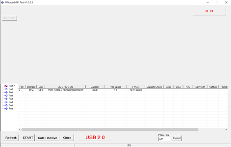

Thanks @alpaca. I'm giving up on this POS RTL9210 for a while, but will keep monitoring this thread and hope for some fix.
In the meantime ... Has anyone tried the new firmware released by Jeyi? Released a few weeks ago.
Version 1.32.49?
For me, it was a real turd. Crashed the computer after being connected a while.
I'm beginning to think 10 gbps usb is just too flakey to trust.
I wonder how many times we can flash these chips before wearing them out ... LOL.

Jimminy
May 19, 2020
264
94
@Jimminy That is quite a lot and indicates, that ASPM is not going into effect, as 1 W is typical idle power consumption without it enabled. Maybe try and and set ASPMDIS to 0x01 and measure it again. I would not trust those variable names 100 %.
I think I figured it out. I never got good results with V 1.32 (it hangs or crashes the computer), so I went back to V1.31, which worked well, but wouldn't suspend during inactivity.
What finally worked was setting EN_U1U2 = 0x1. Apparently, this enables the USB sleep states, and is required as well as ASPMDIS = 0 .
I kept ASPMDIS = 0, and set a 5 minute timeout, DISK_IPS_THRES = 0x5.
Now, the measured current drops to zero when it sleeps. (I'm sure its not actually zero; my usb meter is a very cheap and crude instrument.)
Reactions: Ananas

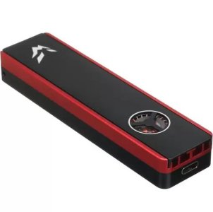

AlexMars
May 11, 2023
7
36
Version 1.32.49?
I adapted this firmware for my device with a fan and backlight. Everything works well. No problem. But I always disable sleep mode in all firmware. Sleep mode is a compatibility issue across devices. I don't need him.
