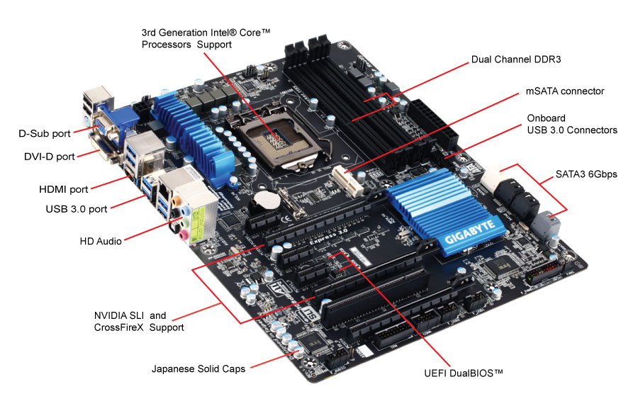

I only have 2 SATA 6GB/S ! If they are marvel or not. I don't have more SATA 6GB/S port !! Do I have to change my MOBO ?
I'll shut off and place HDD on SATA 3 and my SSD on my SATA 2 ports. I'll be right back with a benchmark soon !

You have to have it connected to the wrong SATA 3 port. That's the only logical explanation.
I checked Gigabyte's website, and your board has FOUR SATA 3 ports. Two Marvell, and two Intel..
Like hawtdawg said, make sure you're using the Intel and not the Marvell ports..
Check your motherboard manual to see which one is which.
