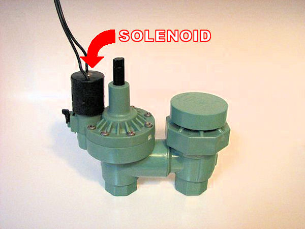

Do you have any zones after that 3rd zone? If not then it's possible the solenoid on your 3rd sprinkler valve is wearing out and is not closing. The reason that shutting the entire system down stops it is likely that you have a master valve on the system which shuts and then allows that 3rd valve to finally close. If there is a zone after it and it's not reaching the 4th zone at all then disregard.
Depends on the brand of valve you have but most of them are very inexpensive and they are all easy to replace. If it's a brand like Weathermatic you won't find that locally and have to get it from a place like Sprinklerwarehouse.com but Orbit and Rainbird are easy to get at HomeDepot.

It sounds like for whatever reason the controller gets 'stuck' on that third zone. IMO if the solenoid was not closing, the controller would still advance and you would have zone 3 and 4 and then 3 and 5, etc., running at the same time. Maybe there is some feedback that would prevent the next zone from triggering but I rather doubt that level of sophistication is needed in a sprinkler controller.
Exactly, this is why I asked if the 3rd zone was his last.
So JM you can take solenoid out of the equation, it sounds like it's going to be at your controller for sure.
