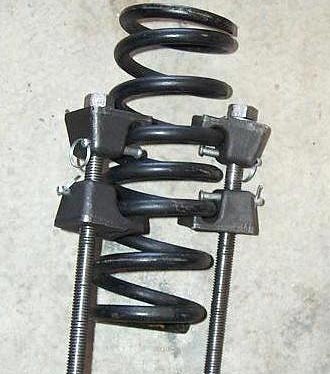

Spring compressors are fairly straight-forward to use safely. Just use common sense!
Couple common modes of failure are: stripping out the drive threads and having the spring compressor slip off the spring.
The first is easy to prevent. Keep the compressor threads lubed up all the time. I use Boeshield on mine. Boeshield a lube/rust protector that drys into a wax, so it doesn't pick up dirt/sand/junk to mess up the threads.
I use ratchets or an air ratchet to crank down the compressor. You don't want to use an impact gun or other high-speed driver. This will heat up the drive threads/nut and increase the likelihood of galling/damaging the drive threads and having them strip out. I've also heard of impact guns causing the compressor to get knocked off the spring.
To keep the compressor from slipping off I have these spring compressors with pins that keep them latched onto the spring, like these ones.
I would not use spring compressors without any sort of safety mechanisms, like these. Big no-no IMO.
Be careful to not compress one side of the spring a lot more than the other, draw both sides down a similar amount. DO NOT crank one side down a ton. DO keep the spring relatively straight. DO attach the compressors directly opposed to each other, symmetrical to the spring.
I always keep myself, and anything I care about, away from the 'death axis' of spring/strut/etc. when working on them, just in case. If something were to let go you really don't want to be in the path of anything heavy.
I'm sure there's a lot more to know about using spring compressors safely. Hopefully other members chime in, also be sure to carefully read the instructions that come with whatever compressors you wind up getting. I'm sure not every spring compressors works quite the same way.

Ive used these and they aren't the best. I while i was compressing the spring the threaded lower part in the picture was rubbing against spring itself.
That spring looks like its for a rear. A front spring i had only had maybe 4-5 coil wrap, so it would also hit the strut mount as well.
The safety feature is great, had no issues but the design is an issue. If those hook were further away it MIGHT WORK.
I rented the "OEM" Brand from autozone for free. I would not buy these myself but i haven't found a better set short of a PRO wall mounted setup.
*shrug* I've never had the problem you described using them on either my Miata or MS3, and my Miata, nor any friends' cars I've used them on. I suppose it could be an issue if your spring has big changes in OD though.
If that's the case, the claw-type that exdeath suggested would work well.
Safety pins, one drive to worry about, and the spring is automatically compressed uniformly. If I hadn't gotten the compressors I have for free, I'd be looking at one of these or something similar.
