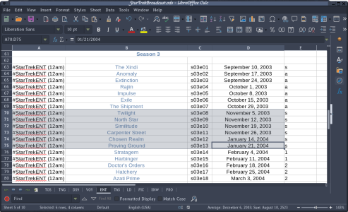

Figured I'd ask here to get spoonfed before looking, cause doing this manually is easy enough, but it would be better having the computer do it. I have a spreadsheet that looks like this...

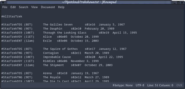

Each sheet is dedicated to Trek series. Each week, I make a list in a text file that looks like this...
What I would like to do is automate this. It's a daily schedule for H&I. It's basically take 1 show from each sheet I specify, append it in a text file in order, increment by 1, and do it again 5 more times for 6 blocks total. Then remember it's place for the next time I do it. I suppose I could do a year of sheets in advance and give each sheet a unique name(maybe weeknn.txt), but my preference is for a single file that gets modified each week.
Anyone know how to do this, or have ideas for starting research? This isn't a huge priority cause it isn't difficult to manually do, but I wouldn't mind putting some time into it to make it even easier.

If you can export it as a CSV, it should be fairly easy to just script something, maybe using python.

I'll probably go the csv route if I take it on. I was thinking that anyway. With csv you can use ordinary text manipulation tools, and gnu/linux has lots of those built in.
I chose a spreadsheet to compile the data cause it makes nice orderly lists. The workflow to get the stuff in a txt file is pretty straightforward, and it only takes about 10 minutes to setup a week of shows.

Just have ChatGPT build a custom PowerShell script & add it to the Task Scheduler! (or Bash & Crontab, or AppleScript & Automator). Python also plays well with AI!

I think I got it! I had to add a distinct episode number to each table, and do a vlookup based on TODAY(). "Based on" being the tricky part, because I happen to know H&I shows six episodes over 7 days - nothing on Saturday. So, like ((floor(TODAY()/7) * 6) + {OFFSET}).
The ep_listing tab is what you want. The ep_calc tab does the calculations. Change the offsets on that page if things get out of sync.

Thank you! I'm gonna have to spend some time studying it to see exactly what you did, but it works!
